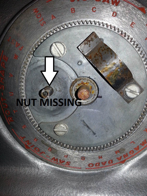

After painting was getting ready to do a high speed adjustment and found this. Anyone know where I can get a speed dial? I"m sure I can find a nut at Lowes. Is there suppose to be a little gear under the nut?
[ATTACH]25790[/ATTACH][ATTACH]25791[/ATTACH]

I have been buying or having repaired all my damaged Speed Control Dials by Ebay seller granny555. Site: http://www.ebay.com/itm/SHOPSMITH-MARK- ... 3392c8a18c He installs a steel gear where the aluminum gear existed. I have been very satisfied with the dozens of speed control dials that he has done for me.
You are missing the Idler Gear 504220, Idler Bushing 504219 and jam nut 124818. Contact me for a bolt kit to replace the quadrant roll pin. This prevents the bracket legs from spreading and damaging the quadrant in the future.
