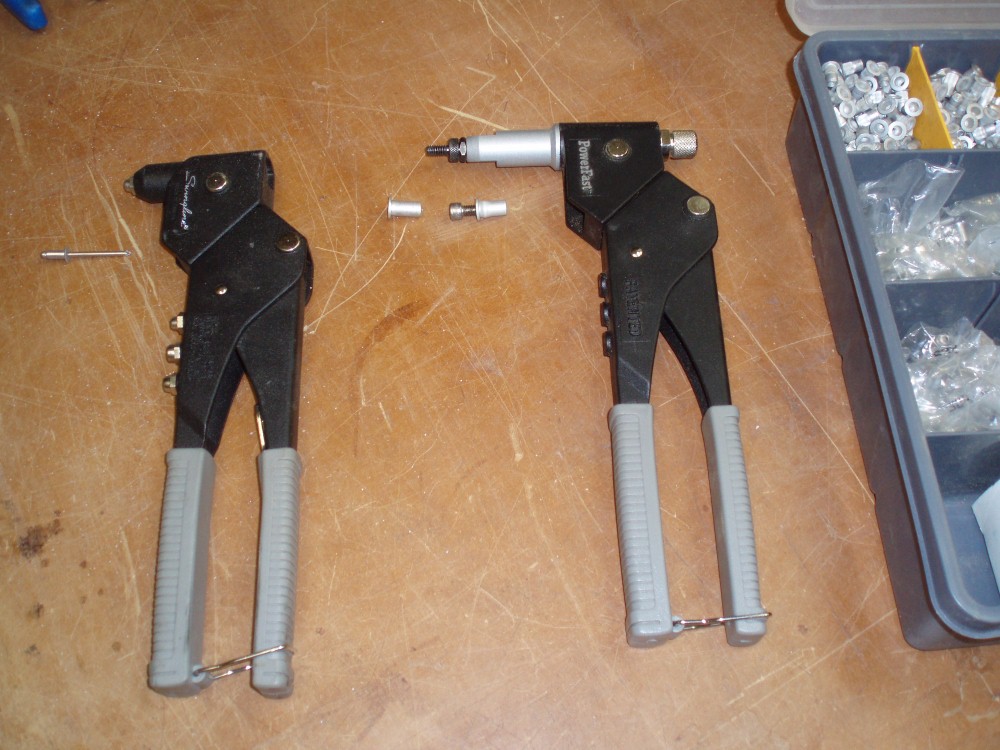

Pop Rivets vs Rivnuts
I think pictures will tell it all. These tools are invaluable when working with sheet goods. I even use the Rivnuts in hardwood. The larger tool is required to expand the nut enough to hold but it works.
[ATTACH]25836[/ATTACH]
A Comparison
[ATTACH]25837[/ATTACH]

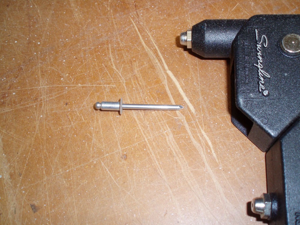

Pop Rivet

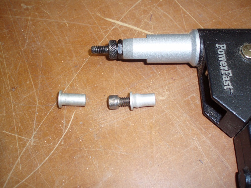

Rivnut Before and After
The rivnut shown is NOT fully compressed.

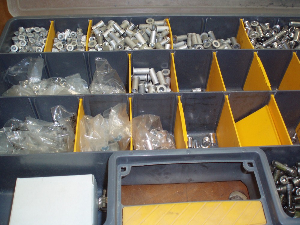

All Sizes Available

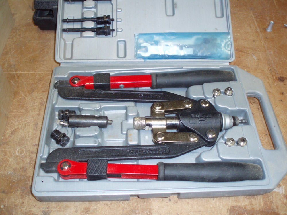

For Heavier Work
A Comparison
Pop Rivet

All Sizes Available

For Heavier Work
