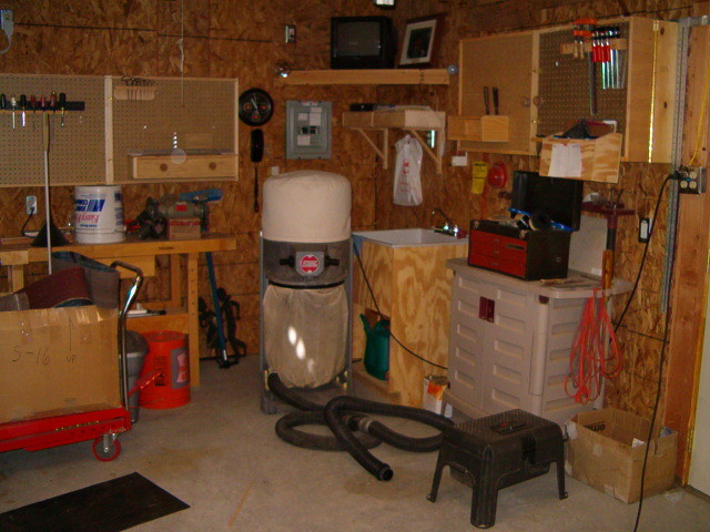

I'm throwing my hat into this thread to support the need for WATER in the shop. Once you have running water, you can find many uses for it. In addition for gluing cleanup, I have used mine for soaking end corners of oak that fell on the concrete floor and made a sizeable dent. Some experts recommend water and a hot iron over cloth, but I have found that plain water soaked into and around a dent will bring it back to the original shape.
I've also found the tub is a good place to wash the family dog. Get a drink in glass from the faucet, wash rags, get water for the wild birds, wash stuff for the wife that she doesn't want in the washing machine, and yes, even pee if necessary.
A large wash tub has been a staple in my last two shops. It is a simple matter to make a support stand for the tub. there is storage beneath (around the plumbing) for shop towels, and a large can of mineral spirits.
Thought must be given to the route for water line(s) and drain line. In my old shop in a garage, I went through a wall to reach both water lines and sewer. I this shop, I had to dig a trench for water and a separate one for sewer. The new tub has a sewer vent beneath the tub.
