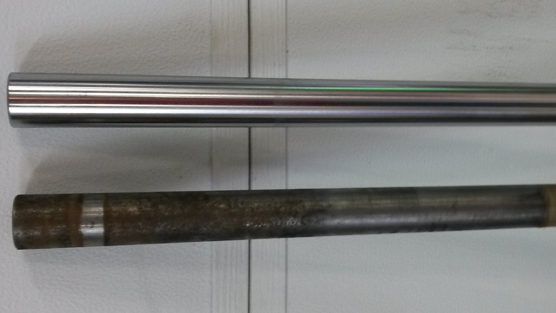

I use a similar way of restoring the Way Tubes. The attached end uses a plumbing plug attached to a router chuck and the free end turns on two wheels. Sorry I do not have a picture of that setup.
- One tube before the other after polishing
- 20150123_110825cr.jpg (309.75 KiB) Viewed 2240 times
