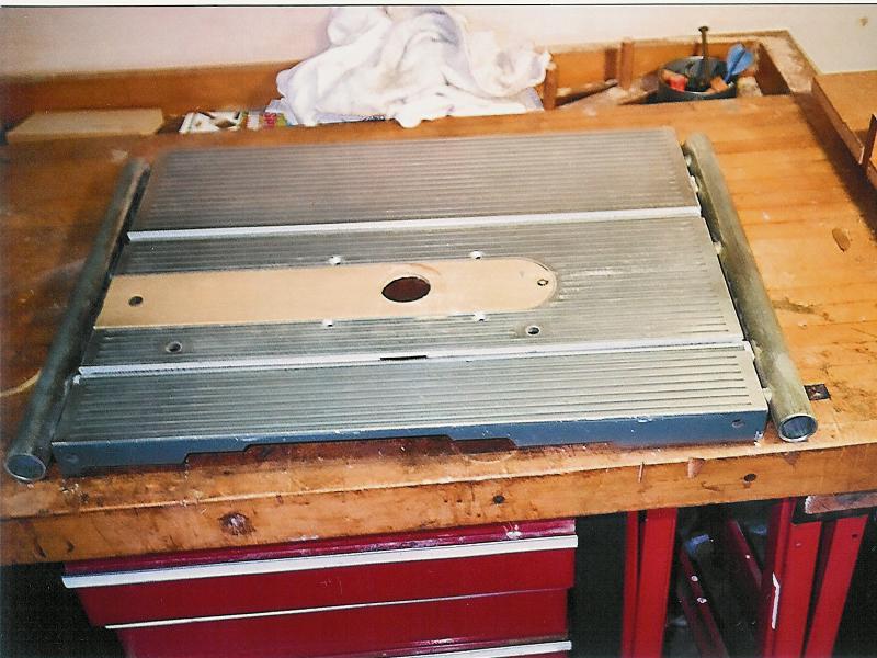

JPG wrote:Since there are two clamping screws, the sequence will vary the result especially if introducing external force(pushing up/down).
The height being different as the tubes are rotated seems to indicate bent tubes(however slight).
What this illustrates to me is that pushing/pulling will alter the positioning of the tube in the rail vertically and maybe deflecting the tube as well..
The design needs to be free to work as intended.
Bent tubes make that intention more difficult or impossible.
Gravity effect on the floating tables most likely results in the same deviation as pulling the tube up.
I am beginning to think the cause/effect/workaround are coincident.
I had the Old Table laying upside down on my SS main table and I measured the height off the Aux table. I figured using the SS as a standard would prevent any variations of using a workbench that might not be perfectly level all over.
With the main table upside down I tigthened the thumbscrews while pushing down on the connector tube or pulling up.
The loosen measurement was to establish a zero'ed height on each test.
Dusty may be right, my tube may be bent but since I gave a loosened or zero height any bend did not effect the test.
Yes the 180 rotation was me loosening each thumbscrew and turning the tube 180 degrees. Again I provided the loosen height which was a rezero of the measurements.

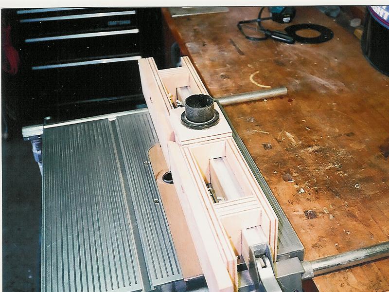

The back rail is on the old 510 (router table) I use the old 510 fence as a router fence. [ATTACH]26836[/ATTACH][ATTACH]26837[/ATTACH]

Let me say about my dislike of the 510 tube situation.
Yes the problem can be corrected if you always pull up or push down on the connector tube and floating table.
However in practice I often forgot and usually it didn't make a difference. However there were times that it did make a difference and it was usually while I was doing a very critical operation.
The 520 method eliminated any requirement on the operators part to insure all tables were perfectly aligned. In other words there isn't a chance of having a table higher or lower than the main table when using a connector tube if the initial installation of the fence rails was done correctly.
That to me was worth the price of the 520 upgrade.
