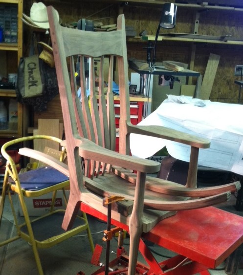

Here's where this project is as of today. Lots more sanding, rasping, grinding yet to do.
A week ago I thought I was through shaping the arms - 0 but OH NO!!! much more to do.
The Pic shows the rocker clamped on the movable rolling lift that has come in handy many times.
I just might leave the front legs look swollen where they join the seat. Remembering the difficulty I had with that joint, hate to screw it up by taking too much. Actually, I now realize the legs should have been carved down before glueing. (do now - learn later)
I will also mention my greenhorn thoughts on grinding down the arms. They are still way too thick but frankly it is scary to grind away more. It will be done, but don't know any way to put back ground wood if too much is taken.

Chuck, this is just fantastic! Already I would take that chair in a heartbeat. Take your time and don't over-criticize; it looks great!

great job! Way beyond the "greenhorn' stage imo.

Greenhorn????
Looks pro to me! I will say it again, nicely done! Your DIL is a lucky girl! ....
