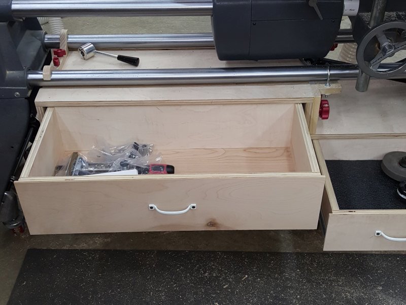

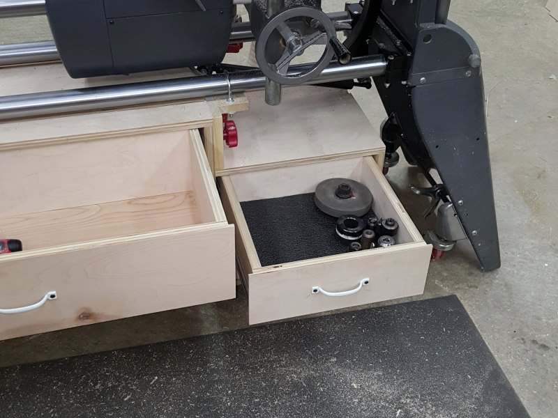

Here are the open door pics.
Jack

Thanks. How do you find having drawers like that? I know myself... Without making some provision for defining what tool fits where I end up piling them on top of each other, with the one I next need at the bottom of the tallest, most precarious pile... I think the same underlying basic natural law enforces the fact that I always find at least four or five Phillips head screwdrivers when seeking flathead, and the same in reverse. Clearly neither are g the fault of poor organizational skills on my part. We're talking the equivalent of gravity here, serious immutable truths deeply embedded in the fabric of the universe.
claimdude
Posts: 460
Joined: Fri Dec 29, 2006 11:47 pm
Re: My take on an under-Shopsmith storage cabinet
Post by claimdude »
For the time being I am just testing different things in there. I had hoped my 520 would fit but it is too long and because of the lift assist I couldn't squeeze anymore width out of it. I am also adding drawers in other cabinets and some items will go elsewhere due to infrequency of use. I should have all my new drawers (added in open cabinets I build 30 years ago before I had any tools to amount to anything) in a month or so and will then begin serious organization using things such as Kaizen Foam (already have a number of drawers organized with it), adding dividers and multiple levels in tall drawers etc.
Jack

From the photos it looks like you are using butt joints for your drawer fronts and sides. For future drawers, I would suggest you use a drawer lock joint, especially if you will have heavy items in the drawers. They will last much longer.
claimdude
Posts: 460
Post by claimdude »
Bruce,
I did use butt joints but also have a Festool Domino and used dominos and glue in the joints so strength is not an issue.
Thanks
Jack
