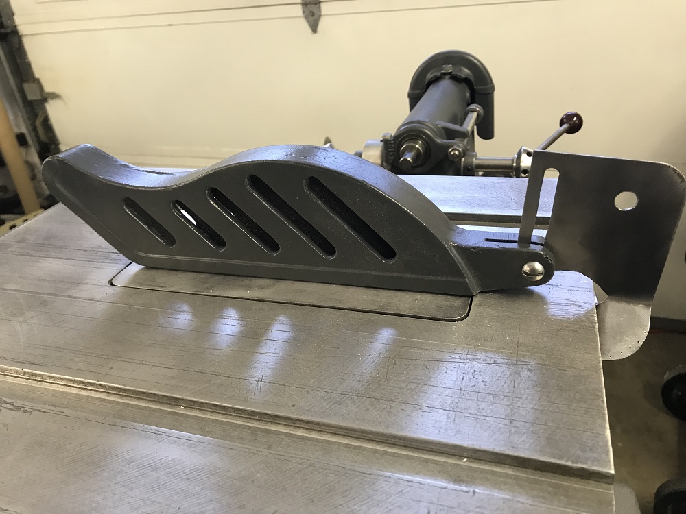

Posts: 4546
Re: Non woodworking uses for a shopsmith
Like Dick and John I use my Shopsmith Mark 5 520 which has now been upgraded to a Mark 7 to restore Shopsmiths. I am almost finished with my 21st restoration. I polish the tubes with a setup almost the same as John's. I use a pipe plug attached with a Router Chuck and a board with small wheels on the extension table. A lot of wire brushing & polishing wheels for parts and most recently used the drill press and jig saw (without the upper arm) to make two Model 10 blade guard splitters. The one below is for S/N 1077 shown on S/N 4708. Note the narrower distance between the slot and leading edge. This was required because the 1077 blade guard has a shallower splitter slot. I did not want to cut down an existing splitter and I was already short two splitters for the upper Blade Gruards I already have.
Custom Splitter for S/N 1077

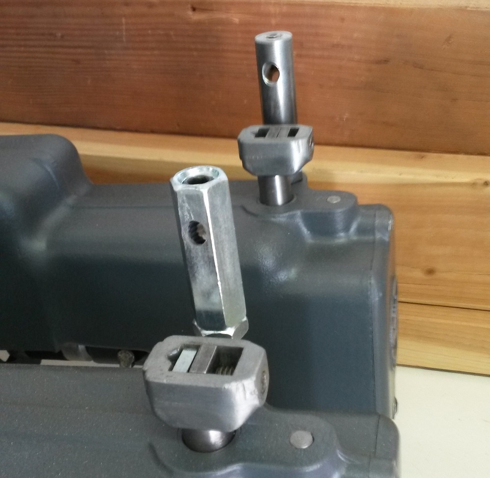

On a Jig Saw I restored a couple of years ago it was missing the Sabre Saw Guide so using my Mark 5 I made the replacement shown below. It's not round like the original but is just a functional.
Saber Saw Guides
Saber Saw Guides
