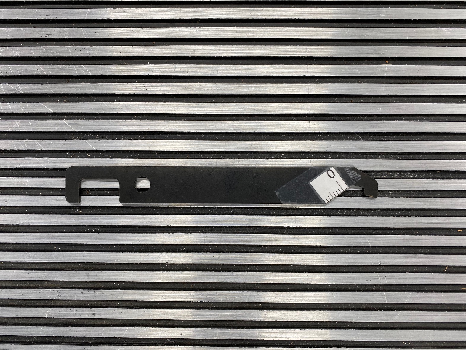

I know this is an old thread, but I found something that works well for me on my planer knife alignment tool. I have the flat bar type alignment tool, not the curved one. I know the manual states to scribe a line at 7/16" on the alignment tool face. Maybe it is just my vision degrading, but I find it hard to read this in practice. The problem is that the tool is black set against a black cutterhead with a dark grey knife. Even with a lot of LED light shining in/around, it is still a dark cavity around the cutterhead. My point? There isn't a lot of contrast to see what you are doing to align the planer knife with the scribed line on the alignment tool. My method is to print out a paper ruler and tape it to the alignment knife. Most printers are good enough quality today that you can print a reasonably accurate ruler. Using the link below and making sure your print settings are on the 100% scale, you print the ruler out, then cut it at the 7/16" mark. I have a stereo microscope in my shop (alternative is to use a magnifying glass), so I was able to line up the 7/16" mark fairly precisely with the transition on the tool. I taped it in place. Now, when doing alignment, I just use the ruler "0" line to align my knife to. If you do try this method, make sure you double-check that the printed ruler is accurate with a good ruler from your shop. Using this method, I find the high contrast of the white paper against the dark backdrop of black cutterhead and dark surrounding area helps my eyes to see better for aligning the knife. Anyway, I found this method preferable, so just wanted to share it if anyone else wants to try it.
https://www.printablerulers.net/preview ... inch_by_16
Re: pro-planer knives?
I LIKE THAT!
