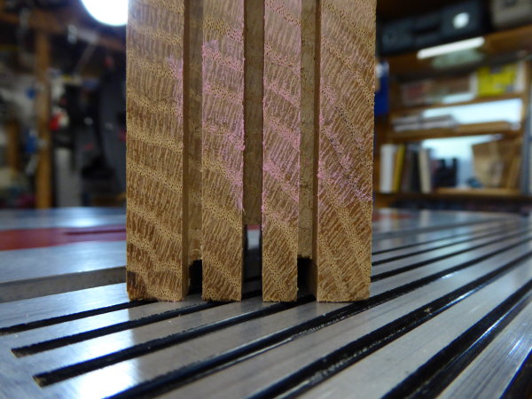

reible wrote:Look, my cuts look the same way. As in I can reproduce the same issue. As I expected in is just plain as the nose on your face.
BTW both cuts have the same issue but it is very difficult to see on the short cut. I would expect if I cut even deeper it would be even more obvious but I'm done with this little experiment.
Maybe it's the picture perspective, but it looks more to me that the kerf is closing on the bottom of the deeper cut.
robinson46176
Posts: 4182
Re: Problem Ripping a Groove
Post by robinson46176 »
The more I look at this thing the more I would have to rule out blade flutter as a cause of the "dovetail" look of the cut. For years I used a Shopsmith Dado cutter (still have it here somewhere) where you have legs with carbide teeth and you control the width of cut with what amounts to "wobble washers"... While it can produce a very slightly curved bottom of the dado the sides were always straight up and down as far as I could ever tell by checking the fit.
This cut is far too shallow for a 10" blade to ever deflect enough to widen the deepest part of the cut but then straighten out so quickly as to not also widen the the shallowest part of the cut (like when using wobble washer cutters).
In short, I think Reible is correct... (shrug)

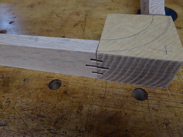

A couple have asked to see the beginning of the cut so here is a pic of the front of the piece I first posted...
JZ 010165.jpg (80 KiB) Viewed 2954 times
The sequence of cuts was the two shallow followed by the center, keeping the same edge to the fence for all grooves.

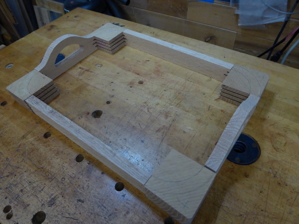

And just because, here's a couple pictures showing most of the parts and another detailing the corner block with the issue.
JZ 010166.jpg (64.03 KiB) Viewed 2954 times
JZ 010168.jpg (67.65 KiB) Viewed 2954 times
Thanks again for everyones comments. I guess I better be more careful.
