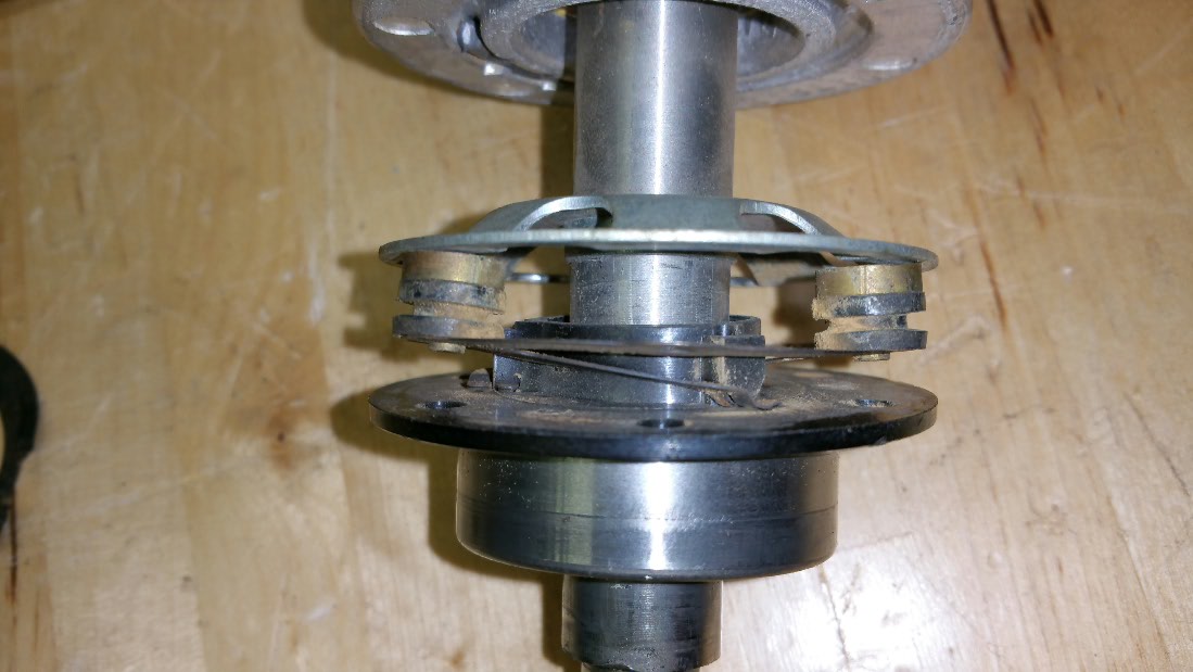

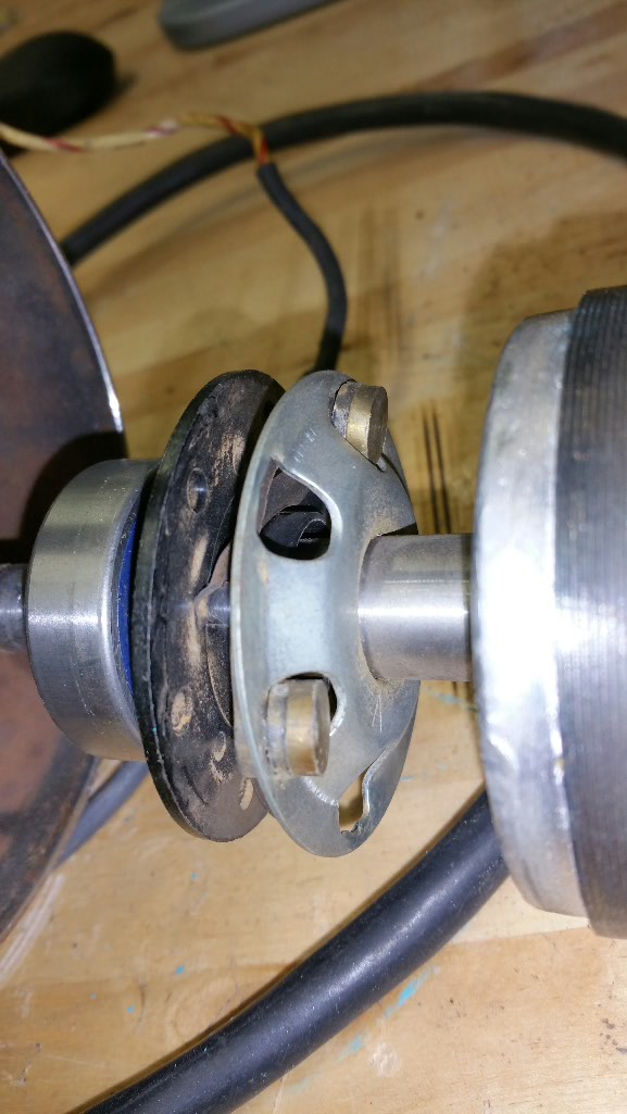

This shows how I positioned the centrifical switch so that it would keep the starter switch contacts closed.
2015-10-15 16.12.05.jpg (92.89 KiB) Viewed 1515 times
This photo shows how the centrifical switch was sitting on the rotor. It was riding a little high which caused it to open and close the contacts on the starter switch when the motor was at rest.
2015-10-14 10.31.43.jpg (92.88 KiB) Viewed 1515 times

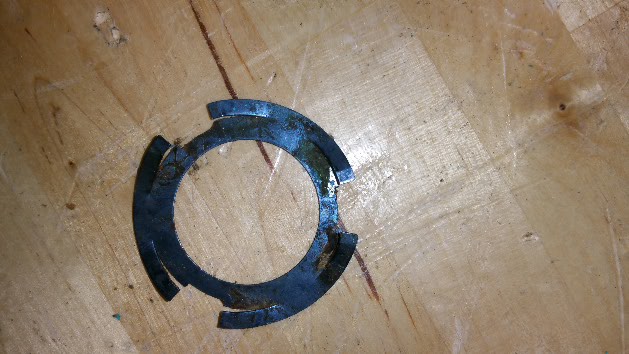

Part that I left out of the front end cap of the motor.
2015-10-15 16.21.51.jpg (61.59 KiB) Viewed 1515 times

Look closely at the bearing liner in this picture. There is the exact same spacer as in your last picture. It is a 1/2HP A O Smith motor from a 10ER.

I didn't remove the black piece, without the spacer in the end cap, it wasn't positioned correctly, so it wouldn't hold down the contact on the start switch when at rest.
I have it all back together now and it runs reasonably well. The motor is a little noisy, but goes great in both directions.

Yes! I did notice that before. That was one of the things that made me realize that I had made a great and greivous error by removing it completely! ;)

You will likely find that spring behind most bearings(even the belt sander). It presses against the outer race to allow slight movement as the temperature changes or from any other 'need'. The motor output shaft end is typically solid.
I question the lack of that spring to be 'the culprit'.

I am not sure what you mean that the output shaft end is typically solid. The pre-load spring washer in the A O Smith 1/2HP motor is on the output shaft end.
FWIW, the F-5 aircraft generator has a stack of Belleville washers (spring washers) in the bearing liner on the output shaft end.
