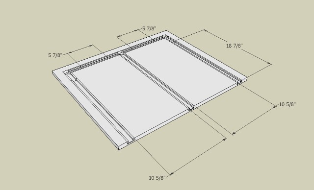

I am in the process of embedding t-track in my rolling work bench. I made some sketchup models of different configurations to help decide how I want to go about this. I haven't decided as yet. I'm waiting for a top bearing pattern bit ordered from MLCS to do the grooves for the tracks.
Which configuration do you think looks the most useful? I'm leaning toward the three legs. If anyone has suggestions, please let me know.

Hi George! For what it's worth, I've had three vertical oriented strips in my fixed workbench for 4 years. Which one or two I use depends on how much other stuff is cluttering up the bench. I've never had a need for a horizontally oriented one. Often, one hold down is all I need. Sometimes one hold down and a clamp at the edge of the bench.
I did make a counter bore at the rear of each strip to allow me to put in and remove the hold down bolts. I use those angled blue hold downs from Rockler.
OOPS! Forgot to post the pics.
I was planning on just three running width wise across the bench but your idea of the three connected to one running length wise seems like a good idea or even the one running around the perimeter of the bench. The perimeter one if done properly would result in a workbench that closely mimics Kreg's new clamping table. However I wonder how often you would need the full perimeter so the three leged which would yield nearly same results but makes better utilization of the tracks might be the winner.
The biggest concern is insureing the width wise trackes are perfectly perpendicular to the length wise track and perfectly parallel to each other. The will require "very" careful layout, cutting and installation.
I'm tempted to set the track into the table a little recessed so there is no danger of slip up with a saw cutting the track, although aluminum shouldn't be a problem if it did get nicked.

Chuckcharlese wrote:Hi George! For what it's worth, I've had three vertical oriented strips in my fixed workbench for 4 years. Which one or two I use depends on how much other stuff is cluttering up the bench. I've never had a need for a horizontally oriented one. Often, one hold down is all I need. Sometimes one hold down and a clamp at the edge of the bench.
This was my thinking until Curiousgeorge posted his pictures. I instantly saw the likeness between his peremeter one and the new Kreg clamp up work table.
I use pocket screws a lot and having a perfect 90 degree corner to hold both boards against when I drive in the screws woud really be handy. I'm way to cheap to buy the new Kreg bench so Curiousgeorge's idea is real attractive to me.
Like I told Curiousgeorge I'm not sure how often I would utilize the back track so I'm real tempted to go with his three leg connected with one lengthwise track.
My only problem is how to insure a perfect 90 degree relationship which would be essential for the table to be used as standard for all glue ups.
