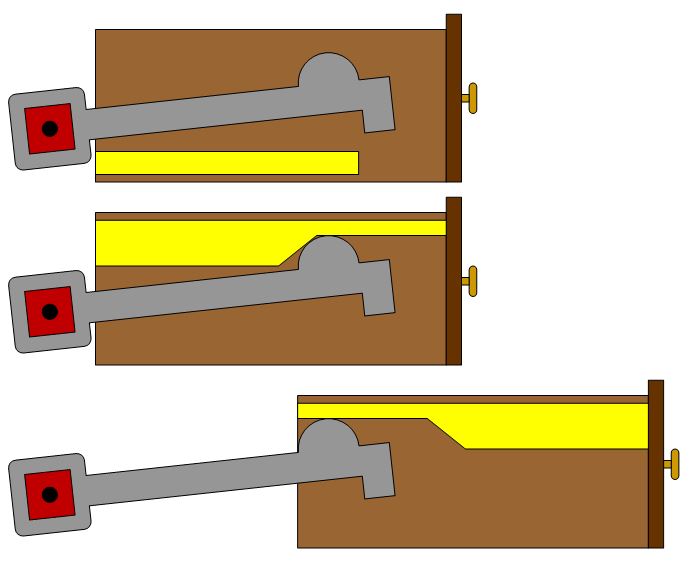

I think I have a concept that is feasible to build. After contemplating sliding mechanisms for a while, I started wondering if it could be done with pinned/rotating joints instead. I believe it can.
Basically, each row of drawers has an associated “drive bar” which spans the entire row, and all of the drive bars rotate in unison. Each drawer has an associated “actuator” which is rotated by the drive rod. The actuators are all identical, but each drawer is programmed as “Must be OPEN”, “Must be CLOSED”, or “Magic Drawer” by installing the appropriate “key” on the drawer. The magic drawers, of course, are the ones that are unlocked by moving all the other drawers into the appropriate position.
In the illustration above, we see a side view of a column of drawers. The red squares are the drive rods, seen from their end, and they rotate about the carcase-mounted pins shown in black. We’ll add a parallelogram linkage later, so that all the drive rods rotate in unison. The grey things are the actuators, and they are shown square-drive keyed onto the drive rods. The yellow things are the keys. They are fastened to the side of the drawer box, and they determine the behavior of the drawers. I envision both the actuators and keys being quite thin – perhaps 1/8” or so, depending on material selection.
I placed the keys on the sides of the drawer boxes because that is where I think they can be packaged into the smallest space. So the drawer slides (perhaps dovetail slides) would have to go on the bottom of the drawer.
It’s not shown in the illustration, but I’d put a cover plate on the outside of the keys, for two reasons. One, it would capture the actuator side-to-side. Thus the actuator can simply float on the drive rod, minimizing any tolerance issues. Two, it would hide the key, so someone can’t figure out the code simply by opening the drawers and inspecting all the keys.

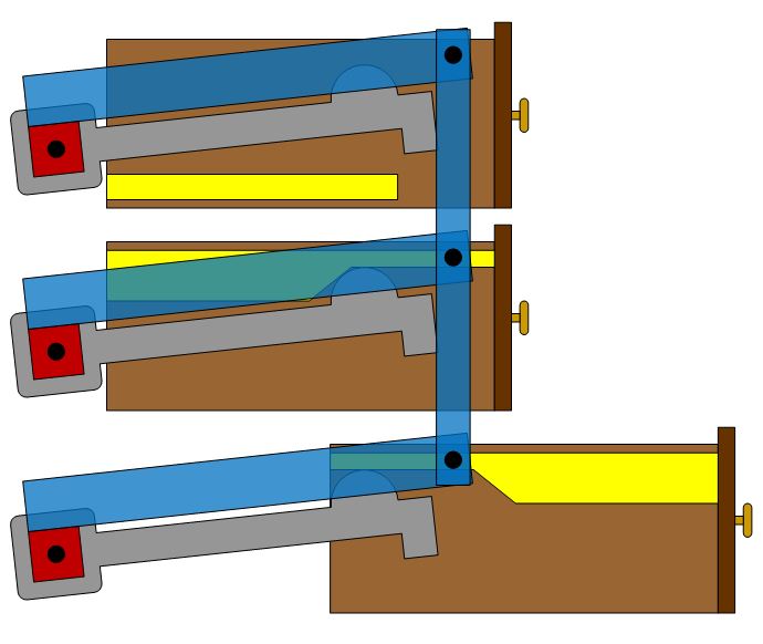

The next illustration shows all the drawers in the position that unlocks the magic drawer. In these positions, no key will block its associated actuator from lifting, and so a spring or counterweight will rotate the drive rods counterclockwise, lifting all the actuators and unlocking the magic drawer. But if even one drawer is in the wrong position, the drive rods can’t rotate, and the magic drawer stays locked.

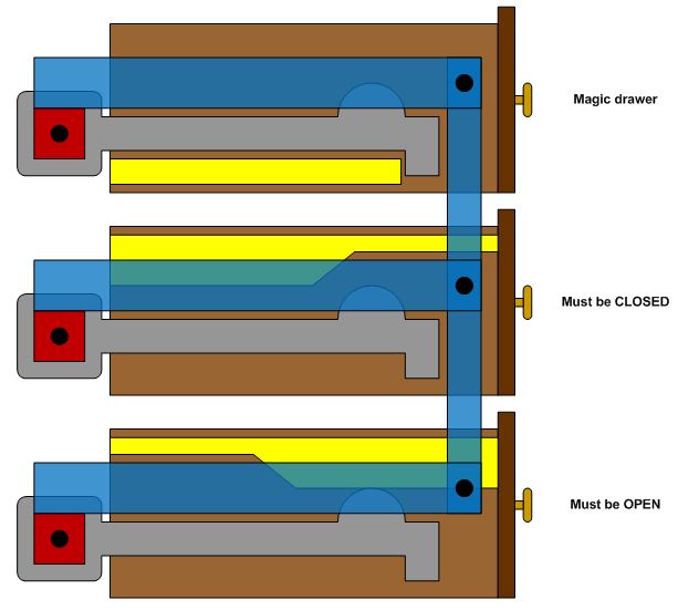

And that’s about it, except for adding the parallelogram linkages to the drive rods. In the illustrations below, I have them shown in blue, oriented toward the front of the carcase. This permits longer links with proportionally better pin-slop tolerance, without having to grow the carcase rearward. I would probably place the parallelogram linkage against the side of the carcase. Possibly on both sides of it, if I was concerned about drive-rod twisting.

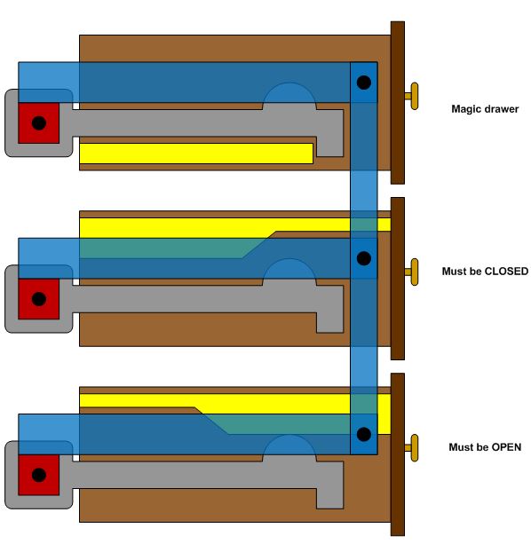

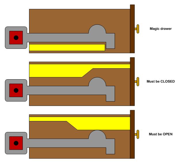

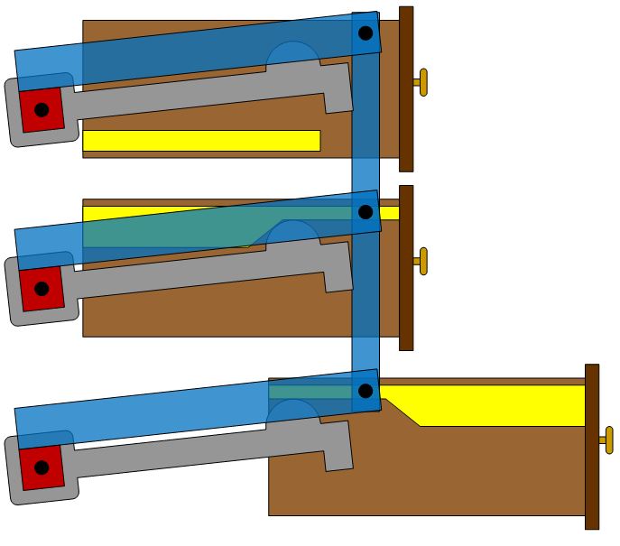

It dawned on me last night that my pins-and-levers concept would package better if you flipped the whole shebang by 90 degrees. So the drive bars are now running vertically, up along a column of drawers. This has the following benefits:
1. The keys and actuators can now be hidden inside double drawer bottoms. So the drawer sides are once again thin and symmetrical, and the drawer slides can be mounted either to the drawer sides or to the drawer bottom.
2. Gravitational loading of the linkages is eliminated. Everything moves in a horizontal plane.
3. The parallelogram linkage can now be located either at the top or the bottom of the carcase. Either way, it doesn't increase the width of the unit.
Below are slightly-revised illustrations, each showing a bottom-view of a row of drawers.

Re: A serious challenge
I do not 'see' the reorientation. Looks like the same pix as before.
I do understand this and really like it!
