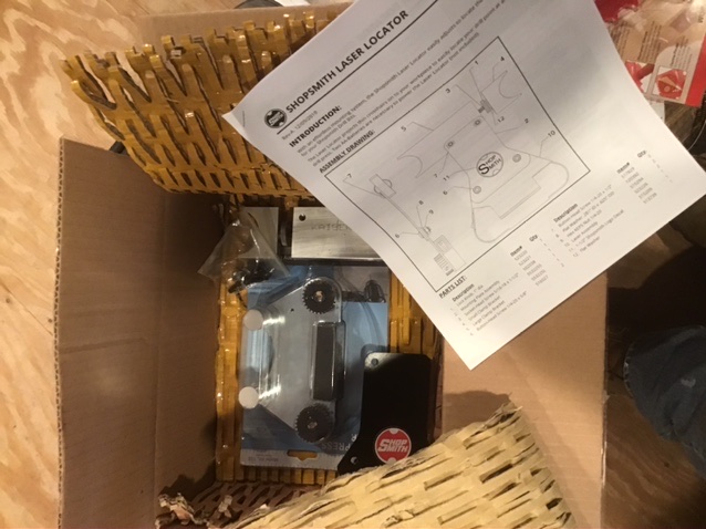

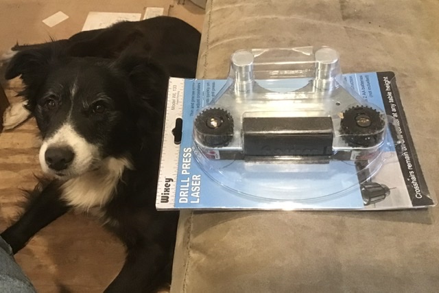

Well jsburger I got them today. They look fine though the package.jsburger wrote:I made the same(almost) laser for my dedicated MK V drill press back then. It still works great.
The SS version uses the Wixey laser module which is mechanically defective. Many (most) of them arrive broken. Wixey problem not SS. I sent my SS version back today with a refund and won't buy another one until Wixey fixes the problem.
If you actually get yours before SS stops shipping let us know. Don't open the blister pack. There are ways to tell if it is broken.
