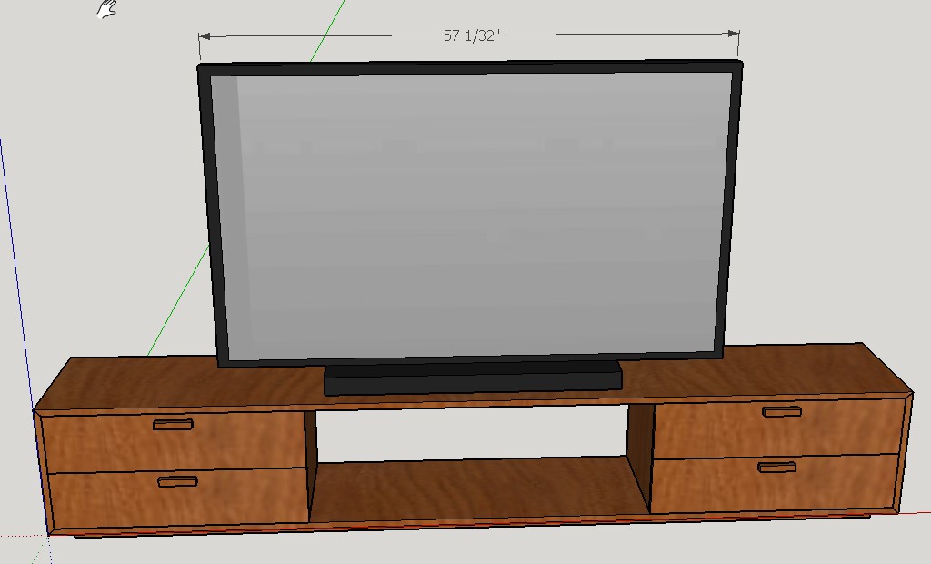

Just for a little fun.
ScreenHunter_94 Feb. 11 09.23.jpg (51.21 KiB) Viewed 3061 times
Ed in Tampa

Re: Build Dilemma
Post by Ed in Tampa »
algale wrote:So here is my wife's sketch. Not shown is the inward bevel on the edges of the carcass.
In light of the stated requirements I think both you and your wife need to rethink this project.
It seems to be a solid wood design instead of a ply wood project.
If you do decide it must be ply then you must consider veneer.
In either case I would make a strong case for buying a guided saw system. :D

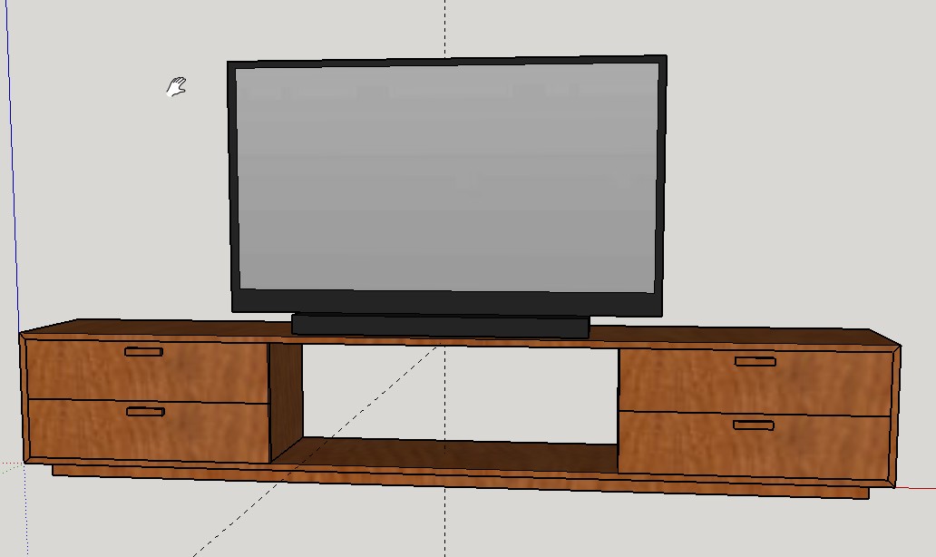

OH NO
I went with a 55" TV rather then the 65"........... see revision below.
ScreenHunter_95 Feb. 11 09.34.jpg (59.08 KiB) Viewed 3058 times
algale

Re: Build Dilemma
Post by algale »
reible wrote:OH NO
Ed, that is really nice of you to draw this up for me in perspective. I wish I knew how to do it!
