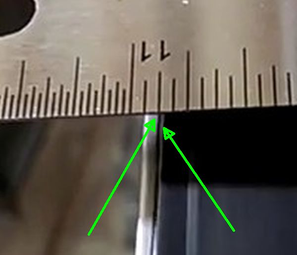

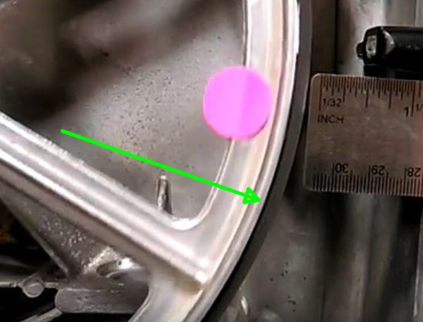

I watched the new video of the wheel for wobble. I see very little wobble. So we are all looking at the same thing I did a couple of captures. The arrow on the left is the location I was watching for wheel movement. And yes there is some but not that much.
The tire does have a pretty good amount of movement. You can see that by looking where the right green arrow is. Is it too much? I don't think so.
Now this is in a relative static state with no loading so I think the next step is to install the best blade you have and redo this video so we can watch the blade for movement. Since the issue could still be here but unseen perhaps having the tension applied will show something else.
I'm now going to look at the second video and see what that shows.

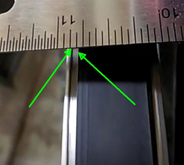

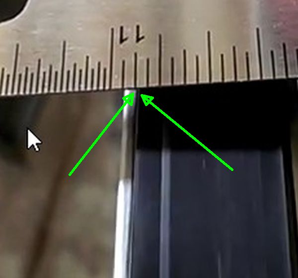

Re: Wobble in Lower Bandsaw Tire
I see one bump. When tires are put on it is not uncommon for there to be thin and thick areas and that is one of the issues one is likely to see. In this video the bump is pretty isolated to a single high location.
Again so we are all watching the same thing I put a green arrow at about the high spot..... I might have missed it slightly so lets call this the general location with the green arrow.
I think this one needs to be redone with blade and tension. The high spot may go away under tension and even if it doesn't it not that big a high spot in my opinion.
I see nothing here to indicate a problem either.

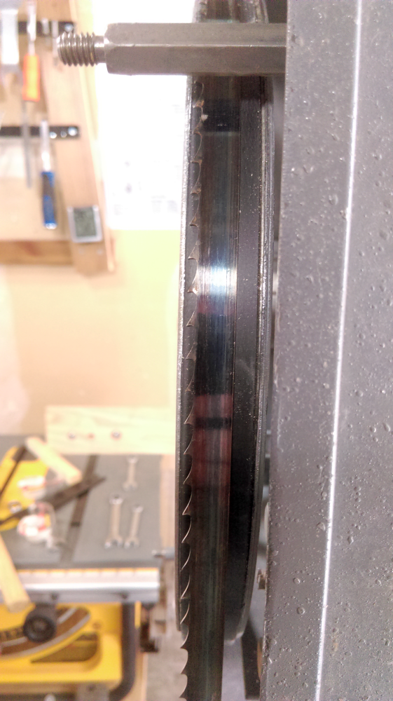

So, I put back together the bandsaw and installed the blade to take a bit more video... Now, I don't know exactly what I did, but the the blade stayed in the track just fine! :eek:
Here is a quick vid to share my excitement!
https://youtu.be/7VfrKSROlTQ
Oh, and I think the blade is running just fine on the top wheel too... Right?
Upper Wheel Tracking.png (764.41 KiB) Viewed 1938 times
