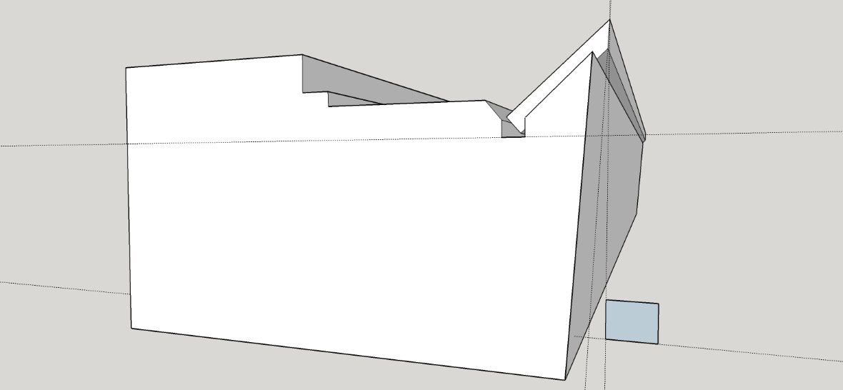

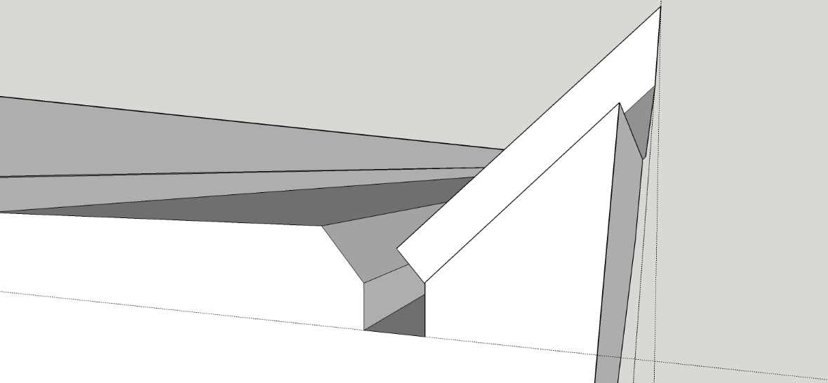

The first thing I must do is offer an apology to John for all of my negative thoughts and comments regarding this subject. I was dead wrong and he was correct. I must also thank Buckeye; it was his comments that made me stop and think.
To bring the whole thing into focus (for me), I had to draw some pictures. I prepared a very accurate drawing (Sketchup) of the sharpening jig and of the planer/jointer blade. With these drawings I could clearly see that the bevel on a planer blade is set back off of vertical by 3°.
That realization that rang the bell. The conical disk is also at 3° off of vertical. This makes the face of the conical disk and the beveled face of the jointer blade parallel. Hmmm. Why did I not see this before I made a fool of myself. Simple. I was taking all my measurements from from a new (unsharpened) blade. A glance at a sharpened blade reveals that most of my blades have altered bevels because I have, for a very long time) been tilting the table to make it square with the face of the conical disk. In so doing, I have altered the bevel by approximately 3°.
- Sharpening Jig Take 3.png (53.75 KiB) Viewed 2700 times
- Sharpening Jig take 4.png (50.03 KiB) Viewed 2698 times

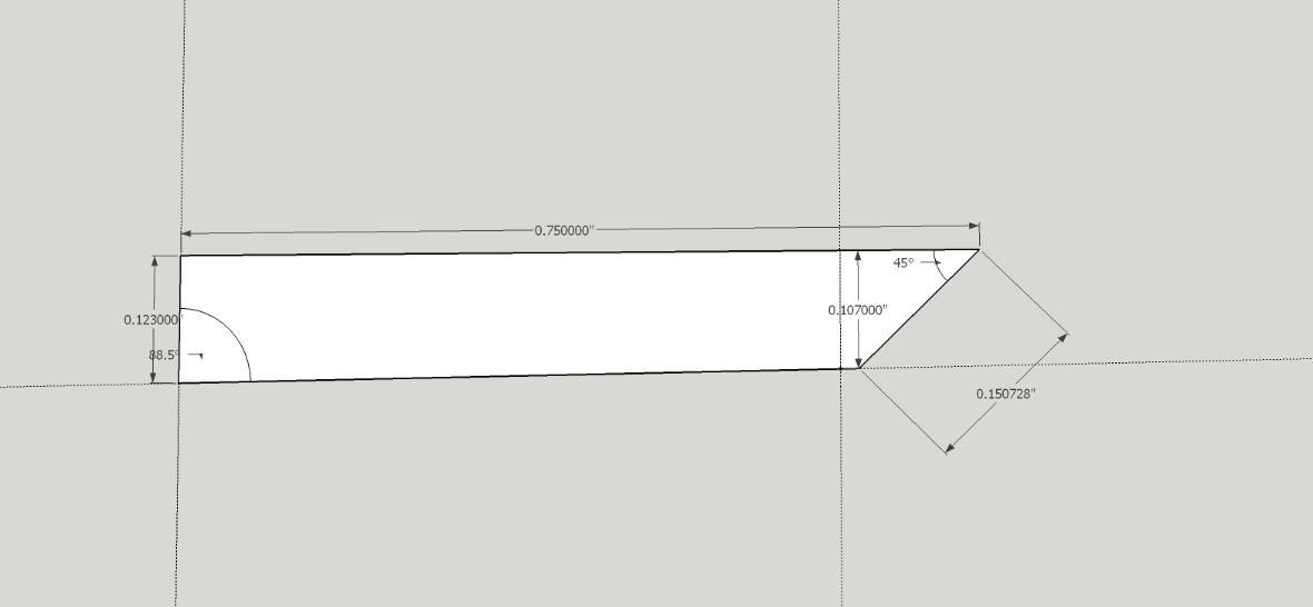

Does this take into consideration reible's statement that he assumes the knives are flat? If not, there needs to be a correction for the taper that is on the Shopsmith knives but not on reible's. That taper is 1.5°.JPG wrote:Assuming all the previous conclusions are correct(0 tilt yields 45°), raise the left side of the table 7°.reible wrote:Now if I were to get this jig and wanted to do my jointer knives at the recommended 38 degrees I would then have to adjust the table to what angle?
See photo below for how angle is measured.
The assumption would be the knifes are flat, at least that is my best guess. So with that in mind talk me how to do the setup.
- Jointer Blade end profile with Dimensions.png (30.22 KiB) Viewed 2640 times
