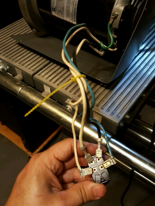

After looking at the switch diagram located here allinonewood.com/svcadv/replacingthemarkvswitch.pdf
I believe the switch may be wired wrong. Any thoughts?
MySwitch
MySwitch
My switch is properly installed with the on position on top.
Re: The usual noobie mistake -help please
Wiring is normal(correct). Later(?) machines only switched the black/blue wires.
Not seeing a problem. You have the white wire from the cord going to the white wire from the motor through the switch and the black wire from the cord going to the blue wire of the motor through the switch. You have a green wire attached to ground from the cord.
If you have an ohm meter you can take the wires off and test that you have zero ohms between where the white/white wires are when the switch in on. Same thing with the blue/black terminals. If either of them are open it will not start at all. Since it will attempt to start then fails there must be some conductivity. That is baring any internal shorts.
retiredsoldier919 wrote:After looking at the switch diagram located here allinonewood.com/svcadv/replacingthemarkvswitch.pdf
