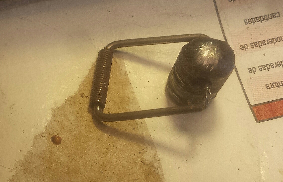

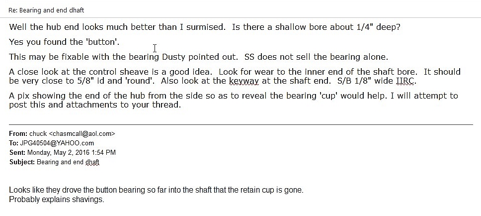

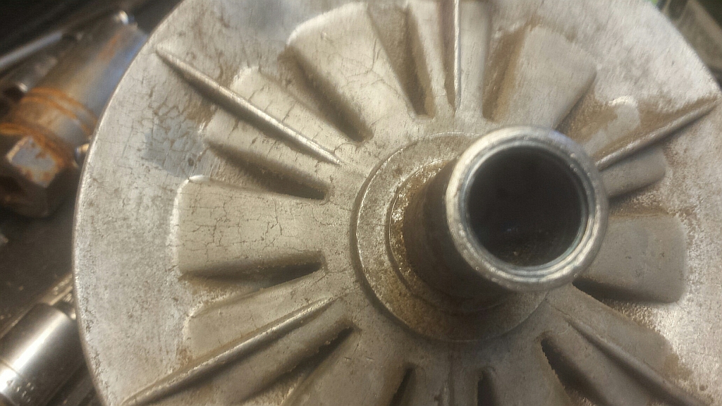

projectdiy wrote:
wa2crk wrote:Is the retaining ring in place at the rear of the 6205 bearing? Just a thought.
Bill V
No it appears to be gone. I did find those in the motor pan but they appeared to be crushed.
Is there supposed to be a "cup" for the button bearing to ride in??
The control sheave hub has a shallow bore that the bearing sets into. The very end of the hub is then staked slightly so as to retain the bearing. The initial pix appears to show that end of the hub is broken.
There is no retaining ring on the control sheave.
The ? regarding the retaining ring is relative to the drive sleeve which appears to be positioned towards the rear too far. That is a secondary issue that we can address after the control sheave etc. is nailed down.
FWIW should be a retaining ring at both ends of the drive sleeve.
Also the rings are not obvious.
damaged email.jpg (206.22 KiB) Viewed 2157 times
damaged button.jpg (546.12 KiB) Viewed 2157 times
damaged control sheave.jpg (420.76 KiB) Viewed 2157 times

Some pix of what you found would be helpful. You may have found the remains of the control sheave bearing down there.
If the retainer is missing from the left end of the drive sleeve it would account for the drive sleeve moving out of the headstock.
As for the control sheave; the bearing is staked into the sheave. The outer race may still be there. There is a guy who posts occasionally on E-Bay that replaces the small bearing and the loop but don't know what he charges.
As JPG said, the rings are NOT obvious. The outer one has to be removed to change the bearings or the poly V belt but the inner one does not have to be removed. It is a real b---h to get it back in.
