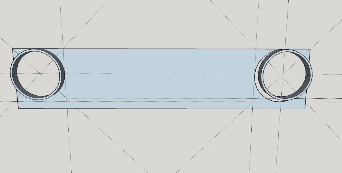

My hypothesis on why the Extension Tables do not align so as to allow end to end swap may be getting shot down (by myself). Part of my theory has been based on the fact that the bench tube separation was somewhat uncontrolled. That is definitely not the case. While the bench tube openings (1 7/8") are larger than the bench tubes (1 3/4") then bench tubes are still properly located with respect to one another.
This sketch shows why I have come to this conclusion. I have been spinning my wheels on this one.
On the left is a tube installed in a hole that fits. On the right is a 1 3/4" tube in a 1 7/8" opening. But notice how the tube is pushed into the upper right of the opening. The top of the tube and the outside edge of the tube are still properly located.
The tube lock bar forces this relationship.
The rectangular area is intended to depict the limitations established by the end castings. The lock bar tends to push the tubes up and out toward those boundaries.

You are obsessing with the wrong part! The openings are clearance holes.
Look at the base casting where the bench tubes are installed. There is the base itself that determines the 'vertical' positioning.
Look to the outer side. There is a small rib that determines the lateral positioning. That rib dimension is different on the 1 7/8" tube bases(1/16" less protrusion).
The clamping bar does force the bench tube into that small rib 'stop'.
What is missing is a 'tube end stop'. That has been corrected with the dual tilt base.

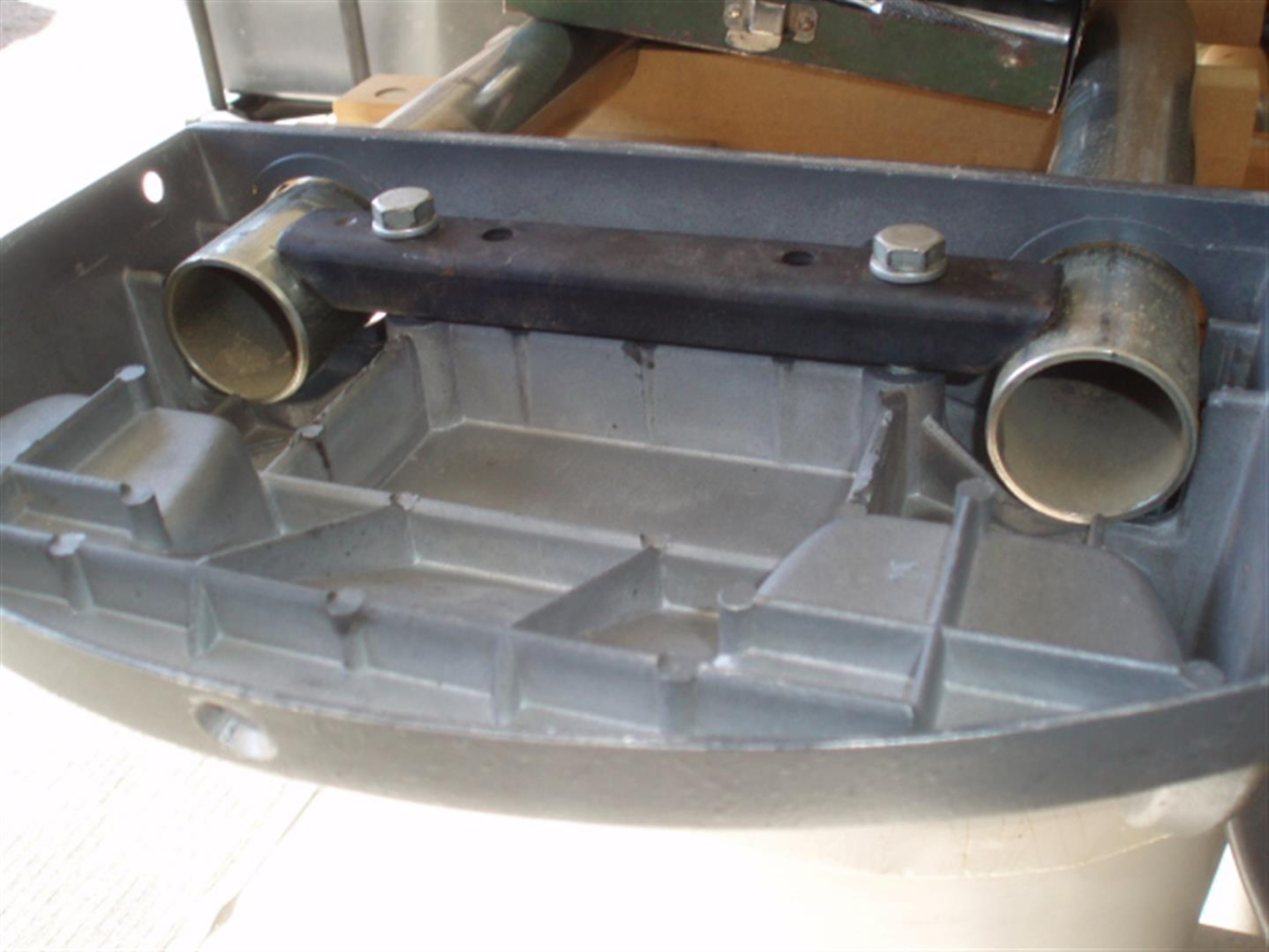

JPG, You made a statement earlier in this post that I thought was incorrect. I am here now to tell you that I was wrong. The Tube Tie Down does not force the Bench Tubes outward until they contact the holes in the castings. The ribs, of which you spoke, establish the lateral limit.
SS Teardown 003 (Large).JPG (580.66 KiB) Viewed 1847 times
This image, probably in addition to some you posted, show the ribs on the sides of the Bench Tubes. It also shows that the through holes are just a little bit larger than the tubes.
I am now ready for my Dual Tilt Kit. To reduce weight, I dropped the motor pan, removed it and the motor, removeds the headstock and carriage and removed the Base Arm Assembly from one end of the Tubes. The other Base Arm Assembly will come off when I am ready to install the new ones.

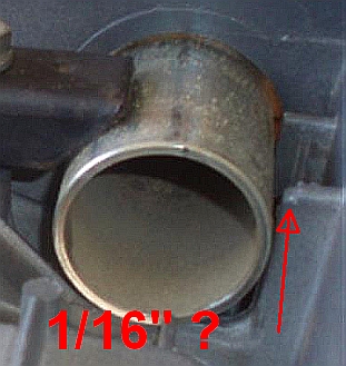

JPG wrote:.
I don't know if that was intended as a question or not but yes there is a 1/16" gap on either side of the tubes. The holes are 1 7/8" in diameter and the tubes are 1 3/4" od.
