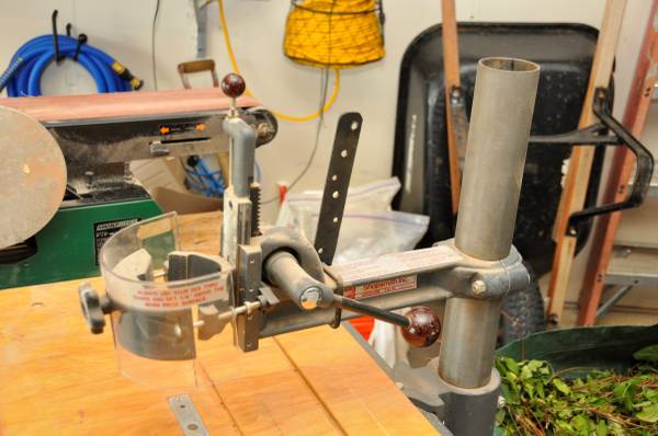

Oops – I did it. Now own the Overhead Routing System by Shopsmith. Vintage 9-30-88, looks awfully close to Ed's pictures. Made the mistake of going over to see it. No rust which is something in this country. Looked in good shape and very little use that I could see. Even came with a router and even the manual. Now have the stand apart adding some much needed angle bracing and maybe some wheels. Next is the overhead assembly. Seems to be pretty loose. Clutch hub and shaft seem to turn together. Rust? Anyway as I go through it will be scouring the forum for information and picking brains. Lots of good ideas on this thread alone. Looking forward to getting operational. Even came up with a place the park it in the garage/shop so wouldn’t have to walk around it, much. If it works as advertised even that might not be a problem.

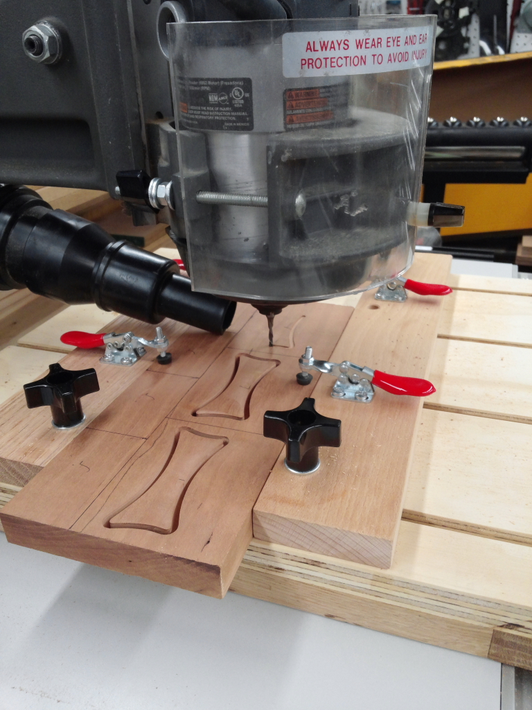

I'd always planned to do a bit of show-and-tell on using my OPR to do butterfly inlays, per Reible's suggestion for my secret-room paneling-board split problems. You new OPR guys have now given me a bit more motivation. Plus, I have to sit up late tonight anyway, smoking pork for a big football party tomorrow (Ohio State Buckeyes vs. Nebraska Cornhuskers). So what better time?

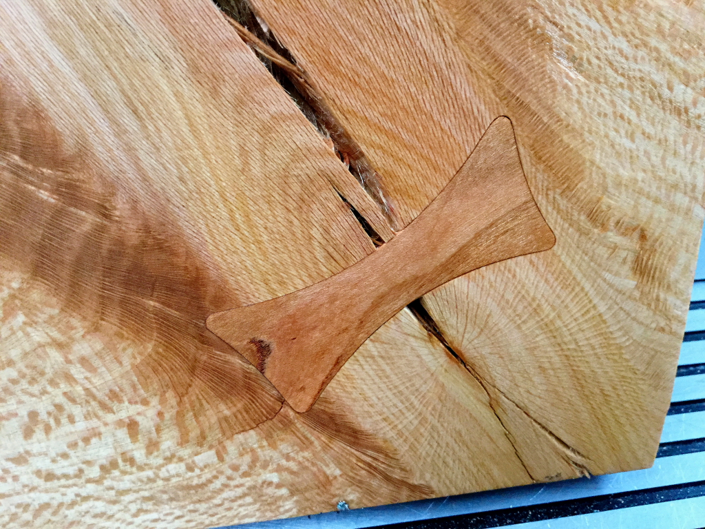

I think that I've already posted this photo on a different thread, but it's a really good example of what you can do with the OPR. This was just a test, in a piece of scrap wood. But it came out so nice, I might just incorporate it into a real project someday.
I cut a couple of butterfly patterns, sized and shaped to my liking, on my SS bandsaw, and then dressed the edges with the drum sander. But the template, the actual inlay, and the inlay pocket were all milled on my OPR.

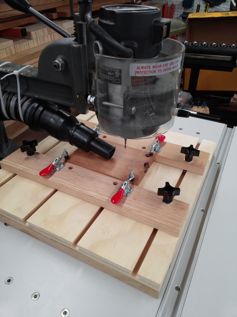

To get to the point where I could do that, I first had to design and build a guide jig, shown below.
I cut the T-slots in the jig base with a T-slot router bit, and bought the miniature toggle clamps from Amazon. The combination works great. The "fence" boards capture the workpiece side to side, and the toggle clamps lock it down tight. I like the fence boards for most work. But if you have different workholding requirements, you can use most any type of hold-down.
And here are some milled butterfly inlays, ready to be resawn free of the workpiece.
In the photo below, I'm using Rockler mini hold-down clamps to fix the workpiece on a diagonal.
On the underside of the base board, hidden by the bottom perimeter frame, is a large recess for mounting patterns and templates. I had designed provisions for fastening those in place with screws, but wound up just sticking them in place with double-sided tape. Which worked just fine. For those who aren't familiar with overarm routers, there's a pin sticking up from the router table, beneath the jig, and directly on axis with the overarm router bit. It rides against the perimeter of the template or pattern affixed to the underside of the jig, and the overarm router then mills a precise copy of the pattern into the workpiece atop the jig.
I also found the standard SS OPR dust port to be almost impossible to use, in practice. So I temporarily rigged the hose and adapter as shown in the photos. That worked much better, but I still had to be careful not to snag the adapter snout on the clamps and such. I have some ideas for a better design, but that's future project.

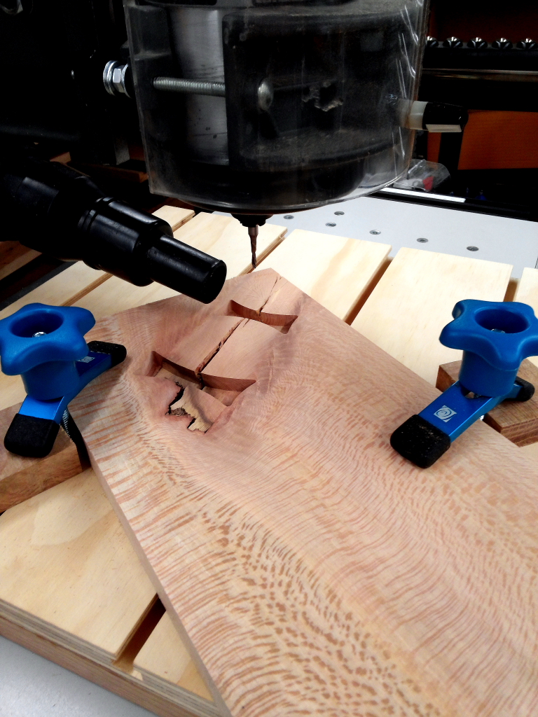

I'm not sure if this is an original idea, but after considerable head-scratching, I figured out a way to make templates that can be used for both the inlay pockets and the inlays themselves. This involves using guide pins and router bits that are of different diameters. That was a brain-teaser at first, but in the end is not all that complicated.
A bigger challenge was dealing with pattern radii that are too small for the OPR router bit to duplicate. Not wanting to spend an inordinate amount of time perfecting hand-tool skills, I shied away from sharp inlay corners that would require cleanup with a chisel. So I attempted to make my patterns with appropriate minimum router-bit radii, and measurements seemed to confirm that I did. But alas, the initial test cuts did not fit properly, and the root cause turned out to be subtle radius problems. The good news is that there is a simple process that can fix this.
I made a document for my own use that details all the steps involved in the OPR router-inlay process. I also have some illustrations that show the underlying geometries. If there is interest, I can clean those up and post them here.
So anyway, after shifting from "development" mode to "production" mode, I found that it was easier to use a handheld router to mill pockets in large boards, than it was to clamp the large board to my pattern jig and slide it around the OPR table. No problem -- the very same patterns work just fine with a handheld router, outfitted with the proper bit and guide bushing.
So for now, we'll end with a few photos from my first "production" run.
