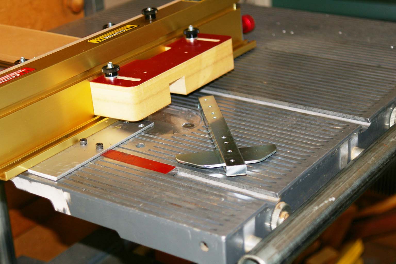

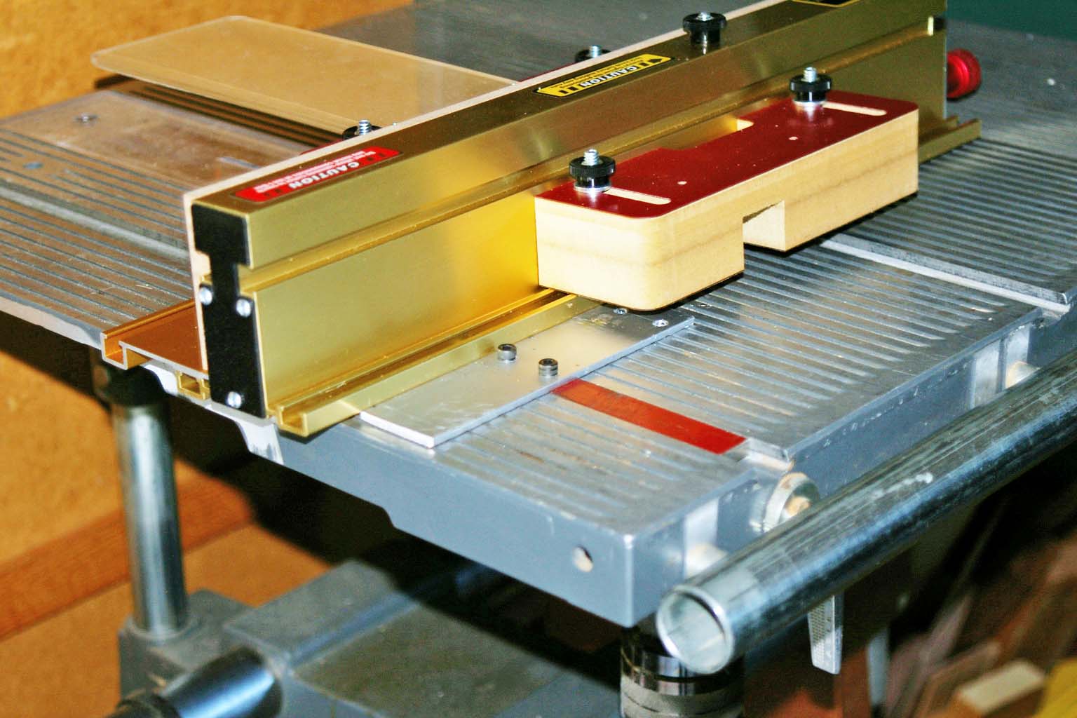

John your post and your excellent work generated my interest again!. I purchased a Mark V mainly to get a bunch of stuff that I wanted and sold the Mark V for a good profit and ended up with a bunch of good stuff!!. One of the items was a Incra-I-Box jig in the box. Problem was and still is the miter bar didn't fit a Shopsmith. Also I have two dado sets, a Freud and a Craftsman neither being for a good clean box joint. I really don't want to buy a box joint set but thought what the heck make it work with what I have. I will probably spring for a Freud box joint set or maybe a Forrest if I get more interested.

Don, Incra will sell the Shopsmith miter bar separately. Go to incremental tools.com. I can vouch for the Freud box joint blades. They are great. First time I used the I had installed them backwards! You could smell the burnt wood! No damage... Just my ego!

Don, I am glad I piqued your interest. As Chris has said, Incra will sell you a miter bar for the I Box to fit the Shopsmith.dgreen810 wrote:jsburger
Don G
Re: I-Box Box

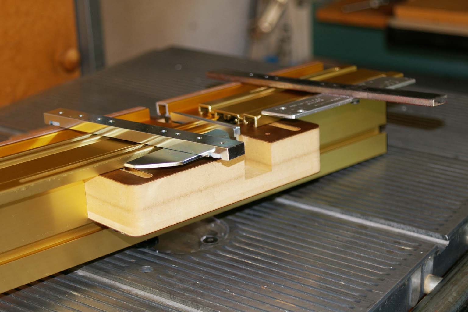

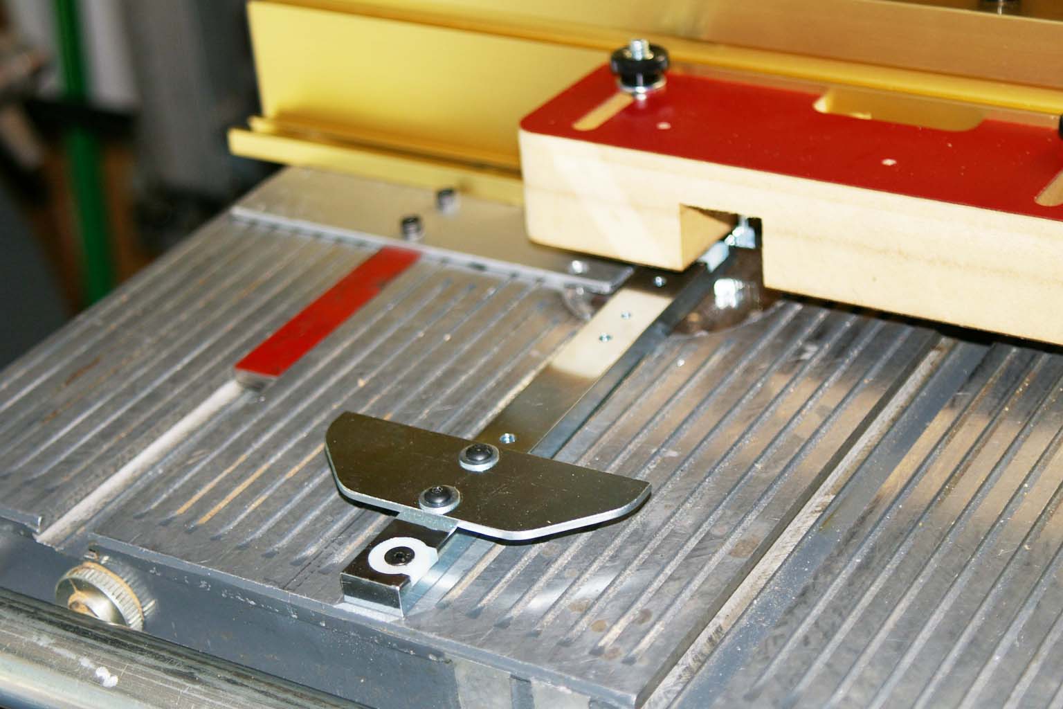

Ya I know. I talked to a young man at Incra and he told me If would ship him this one I have, he would send me a SS one for free. I just didn't want to wait on the going and coming. I am going to mail it tomorrow. Besides, you guys probably have figured out by now, I really like to make things if nothing else to satisfy my own ego that I knew I could do that!!
I thought about making the miter bar from my Incra v-120 do, and it will work, but just didn't want to drill all those holes in it. Had to mill the cold roll bar to the correct width for SS and use a piece of 1/16" Lexan for a spacer to get the correct height. I cut some Walnut and Pecan to 1/2"+ and
ran it through the planer to 1/2". Will play around a little and see what happens.
Don G
Don G
