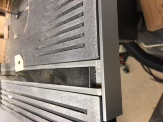

Just had this happen tonight. Only difference is. Don't have a notch! (Head scratch)

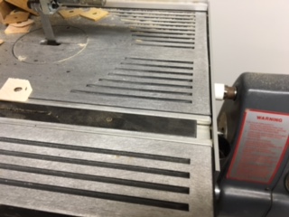

JPG wrote:
ChrisNeilan wrote:No, the fence rail
Mounted 'on the bandsaw table'?
My fence is the Kreg fence, just to be sure where on the same page.
Miter 1.JPG (34.05 KiB) Viewed 2000 times
Miter 2.JPG (31.98 KiB) Viewed 2000 times

I believe you set up your Kreg wrong. From the operator's perspective, that rear fence should be hanging out the back left side of the table. It allows the rip fence to work all the way up against the throat riser.
See this pick.
True also of the front rail. In sum, your rear rail is mounted too far to the right edge of the table (again from operator's perspective).

This could be an "Ah Ha" moment! Doh!

algale wrote:I believe you set up your Kreg wrong. From the operator's perspective, that rear fence should be hanging out the back left side of the table. It allows the rip fence to work all the way up against the throat riser.
See this pick.
So is the front rail with the scale on it far enough away from the table to be able to change blades without removing it? It does not appear to be in this picture but it looks like it might be in the other picture on the SS web site.
