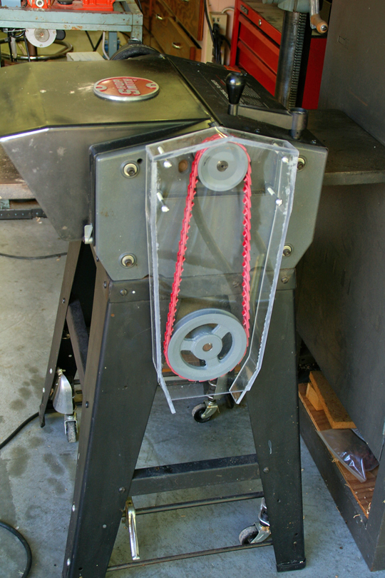

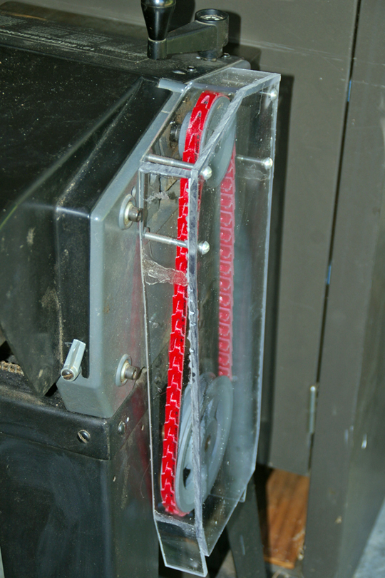

update:
When I replaced the SS pulleys, and belt, I found the Grizzley "Twist Belt" for the 4L replacement rides about 1/8" above the rim of a "A" section pulley. The SS original belt guard is so close to the original pulleys the new belt will not clear the guard. I didn't want to start cutting up the SS guard which you can clearly do. I decided to make a replacement out of some 1/4" Lexan poly. I know it's over-kill but had it so why not use it.
Boy this thing now runs super smooth, no vibrations and quiet.
Don G
Don G

That is one sexy mod Don! Care to provide information on where you acquired those cast iron pulleys (Product numbers and mfg. would be very helpful!)? I might do the mod just because it looks so unique and although my planer is without significant vibration, I would love a sturdier set of pulleys if the prices were reasonable.dgreen810 wrote:update:
Don G
The red grizzly link belt has a nice "don't touch this" flair to it!
Cheers,
John

John I bought from Amazon. Top pulley is a TB Woods AK 3058 3.05" at $ 8.14, Bottom pulley is a TB Woods AK 5658, 5.4" at $ 13.65. The belt is a Grizzly T21992 at $32.99. Note: on the larger pulley I went for an item that was shown as slightly used at about half price. I have found that Amazon lists items as slightly used when in fact they are probably open box or damaged box items that in fact are "New". In any case if it was slightly used it would probably be an item that was returned for some reason but I took the gamble.
If you go this route, it will be necessary that the belt guard will need to be either modified or make a new guard as I did. I just noticed Amazon only has one more AK5658 in stock and the price will probably go back up.
As I stated before, you will be pleasantly surprised at how much quieter and smoother your planer will operate. If you do take the plunge, please let me know what you think?
Don G
Don G
