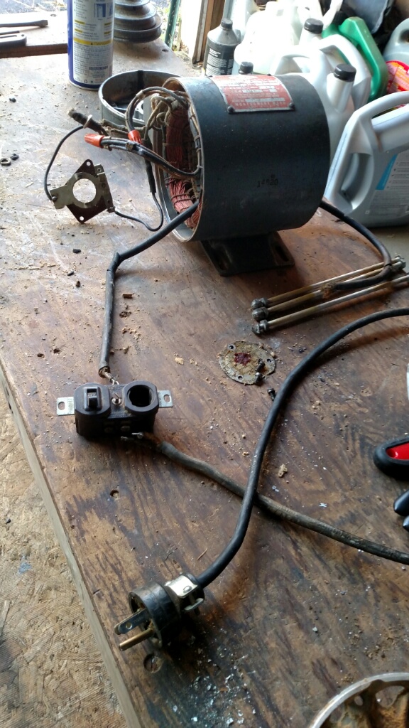

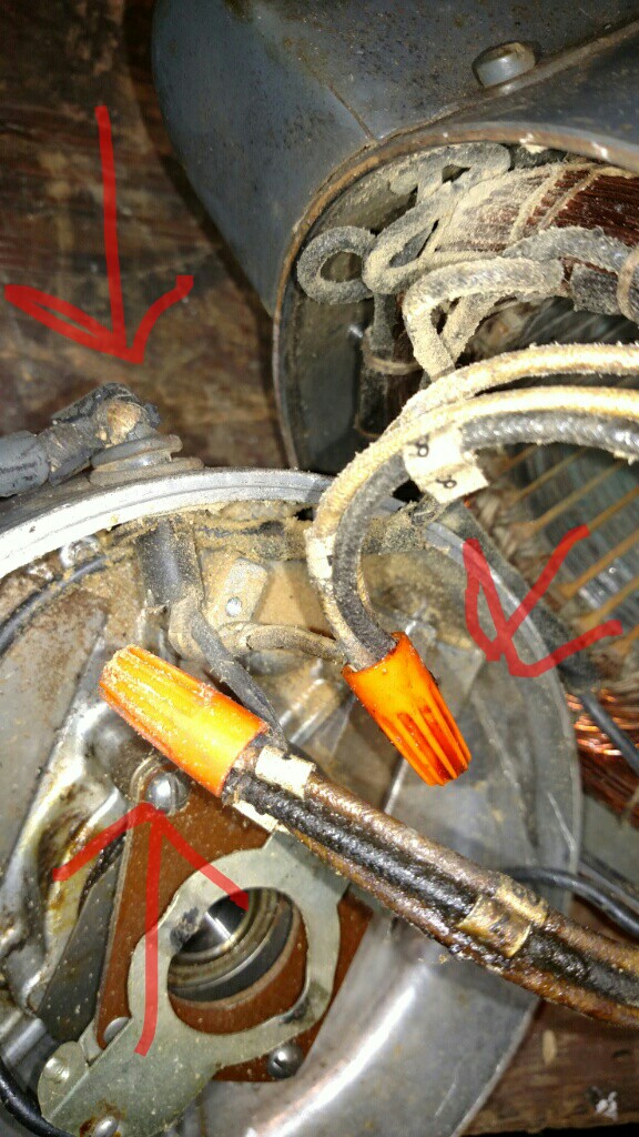

Also to Red and John, here is the "recreation" of the wiring from the motor to switch to outlet. The first pic just shows where the line cord goes into the motor and then one wire is connected to one wire nut and the other wire to the other nut. I cut the line cord off at the strain relief so that's the reason for the pic again. Now, the cord that is coming "through" the motor is the one mentioned above, that then connects to one side of the switch. Then you can see the other half that has the plug on it connected to the other side. Hope this helps? If more info needed let me know.

Re the switch wiring - Atypical, yes, weird, no.
The switch is both a switch and a pilot light.
So both a 'hot' and a neutral need be connected from the linecord.
And both a neutral and a switched hot need to connect to the motor.
Re: My 10ER aka Jane Doe
Well that looks normal to me. Not normal for a 10 ER but normal wiring as near as I can see.Tylerh wrote:Also to Red and John, here is the "recreation" of the wiring from the motor to switch to outlet. The first pic just shows where the line cord goes into the motor and then one wire is connected to one wire nut and the other wire to the other nut. I cut the line cord off at the strain relief so that's the reason for the pic again. Now, the cord that is coming "through" the motor is the one mentioned above, that then connects to one side of the switch. Then you can see the other half that has the plug on it connected to the other side. Hope this helps? If more info needed let me know.
There are two things here. A switch and an outlet. The switch turns the power on and off to the 10ER. That is why the power cord goes through the switch to the motor. The outlet is separate and there are two ways to wire it. Regardless the outlet is wired in parallel to the switch. If you wire it on the input side of the switch (plug side) it will always be on. If you wire it on the output side it will be on or off depending on the position of the switch.
There is a connection from the switch terminals to the outlet terminals. Depending on which side of the switch the wiring is on will tell you how the outlet works.
