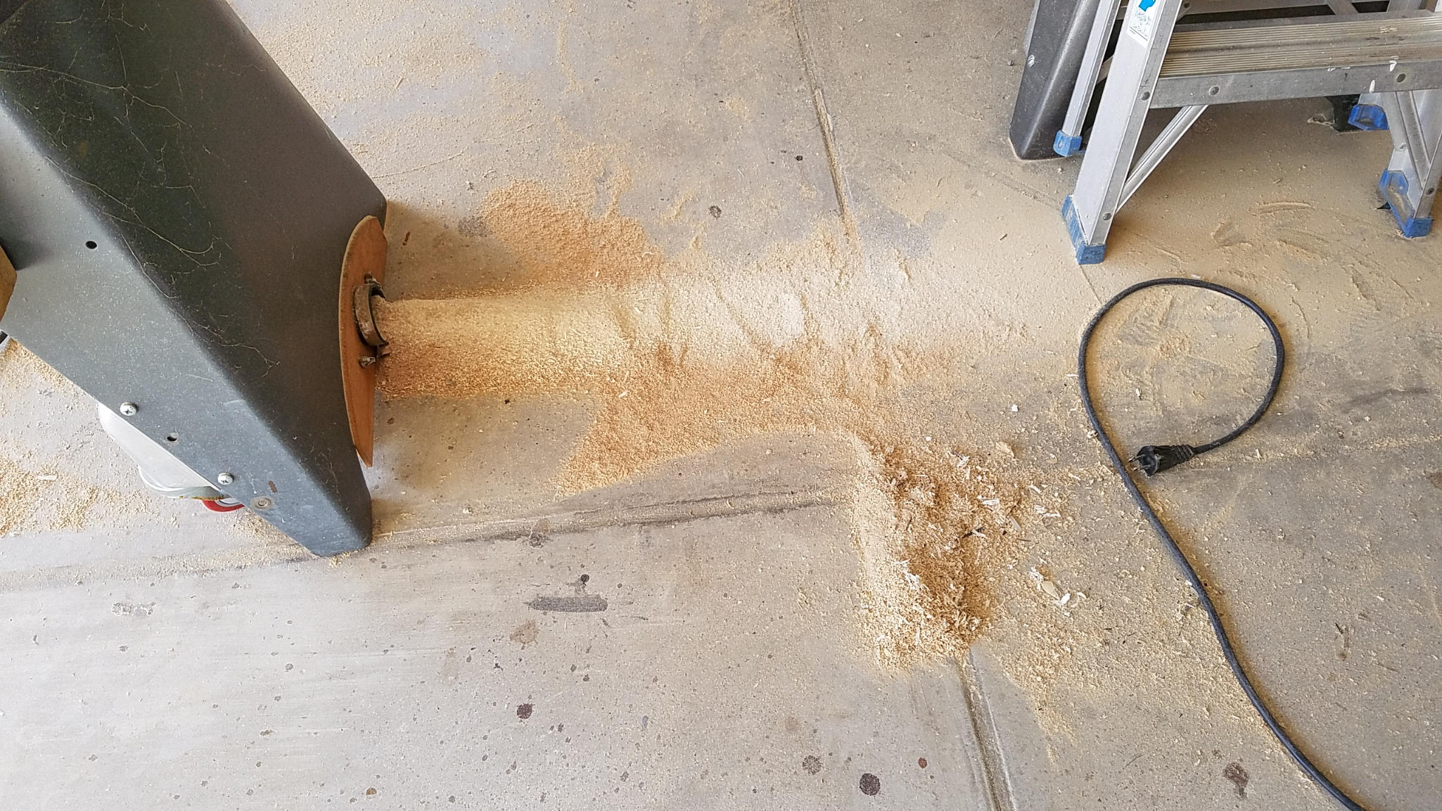

Hang a short section of hose off of the port on the lower saw guard and then do some heavy cutting. The collection of dust the emits from that hose (with no dust collector) will show you that the lower saw guard is quite effective. The turbulent set up by the saw blade does a very good job of moving the dust. The dust collector just sucks it up into a bag.

I don't think that will make much difference or be worth the effort. The 510 saw guard has a channel on the side to guide the dust forced down by the blade to the port at the back.

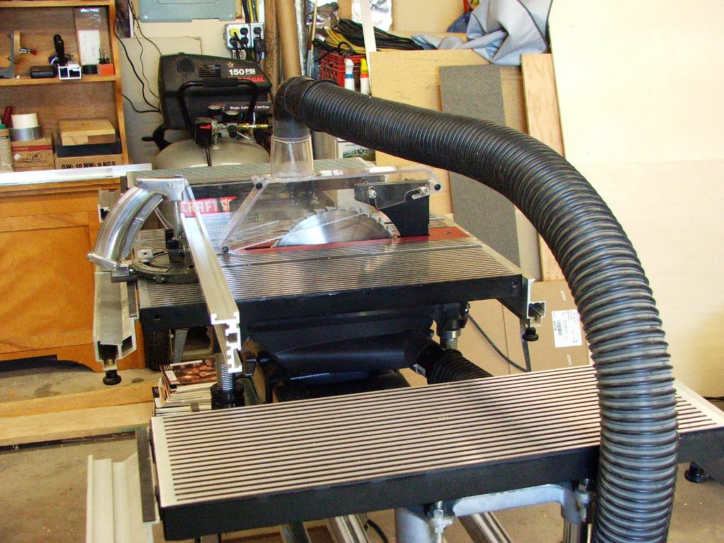

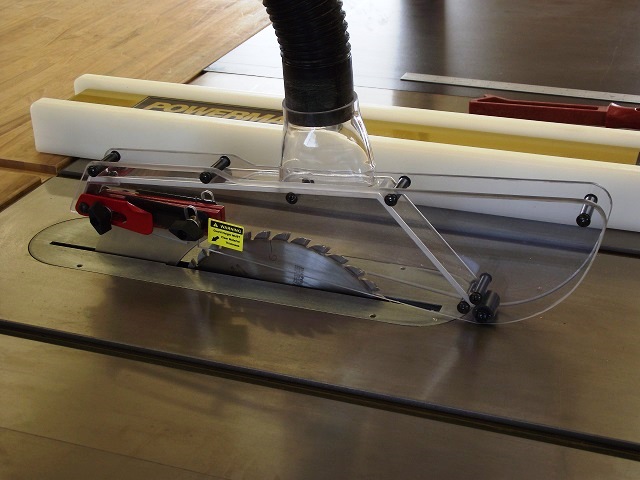

There is a person that makes SS (and most other saws) upper saw guards with a dust port. The Shark Guard from Leeway Workshop at http://www.thesharkguard.com/. I had a very very small part in perfecting the SS version when he started making the SS version in 2007. He has made many improvements in the years since. They are very well made. The picture of the SS version (one of the originals) is from 2007. The picture of my Powermatic PM2000 version is from 2014. He makes them with 2 1/2" and 4" ports.
They are a bit pricey but the workmanship is superb and will improve your dust collection by a tremendous amount. My PM2000 spews dust without the upper guard the same as the SS.

I totally agree Dusty. There is very little dust that escapes the lower saw guard with a dust collector. Most of the dust is from no dust collection by the upper guard. As the blade passes through the kerf on the out feed side it still creates dust that is spewed up on the table. Upper guard dust collection sucks almost all of it up.

The upper saw guard collection port works and works well. It must. We have never seen any sign of saw dust in Johns' shop.
Furthermore, I have worked with a SharkGuard installed and it does eliminate very nearly all of the saw dust that escapes from above the table. If that is the way you want to go, I do not believe you will be disappointed.
I, on the other hand, do not care for the overhead hose and all of the associated apparatus. That is why I do longer have a SharkGuard. Not that it did not collect the dust because it did. I did not care for the setup.

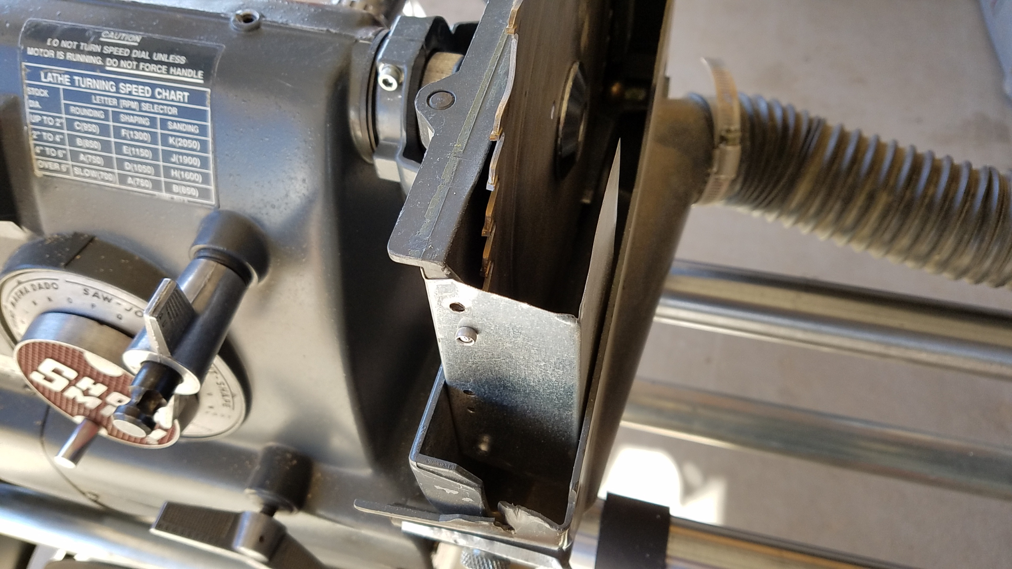

I found a couple pictures of the modifications that I made to my lower saw guard. I am quite pleased with the results.
Lower Saw Guard Dust Collection 017.jpg (1.71 MiB) Viewed 25700 times
Lower Saw Guard Dust Collection 007.jpg (1.96 MiB) Viewed 25700 times
The adjustable portion of the lower saw guard is now sealed (can not be moved). An unbelievable amount of dust escaped there.
Lower Saw Guard Dust Collection 009.jpg (2.06 MiB) Viewed 25700 times
Lower Saw Guard Dust Collection 012.jpg (1.79 MiB) Viewed 25700 times
The lower guard is always open this wide. When I need to tilt the table, I use an unmodified lower saw guard.
Lower Saw Guard Dust Collection 015.jpg (1.96 MiB) Viewed 25700 times
The spring loaded plate is shown here all the way retracted (as in maxmium depth of cut)

Nice modification! Have you ever been concerned that the metal might flex back towards the blade, or is the gauge rigid enough to keep if from wobbling?

ecom1 wrote:Nice modification! Have you ever been concerned that the metal might flex back towards the blade, or is the gauge rigid enough to keep if from wobbling?
That has never happened and I see no indication that it might BUT something like that is always possible. The metal is especially rigid. It is nothing more than flashing material used if roofing.
I was concerned about screws coming loose. I used pop-rivets for that reason.

Nice modification, Dusty. Of course I saw the prototypes on the old thread and contributed one of my own. This one looks like it would be just about perfect for non-bevel cuts.

algale wrote:Nice modification, Dusty. Of course I saw the prototypes on the old thread and contributed one of my own. This one looks like it would be just about perfect for non-bevel cuts.
It works well but it is not perfect. The current short coming is that the blade still brings some saw dust up above the table. This deficiency is corrected by the SharkGuard because it also collects topside but like I said, I prefer to not have all that regalia above the table. Furthermore, my DC3300 will not lift the saw dust high enough to go overhead with the hose.
What would really solve this dilemma for me would be to have a dust collector that resided in the space beneath the Mark V.
