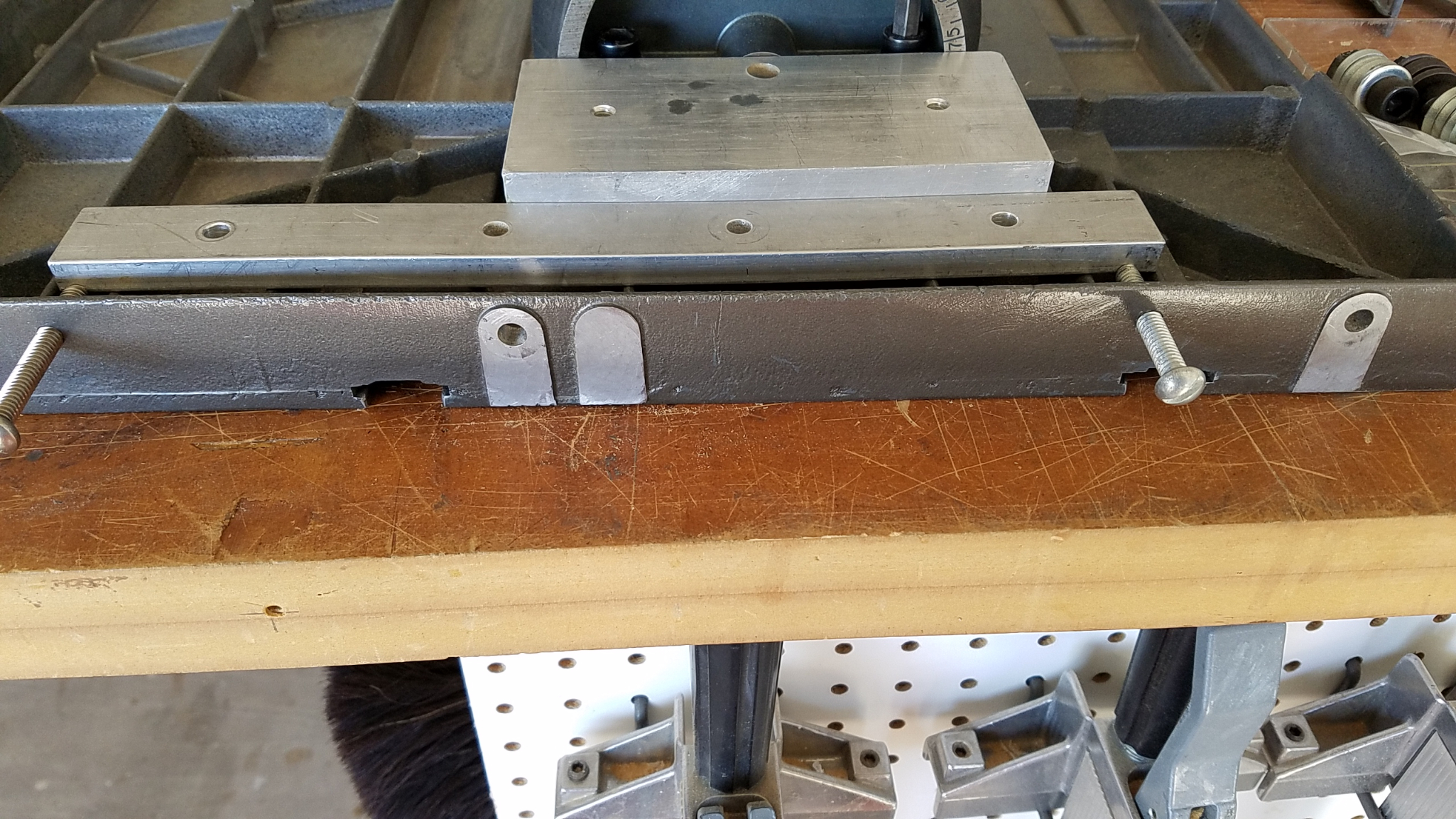

Properly sized, this approach just might work (510 converted to 520 only). The bolts utilze threaded holes abandoned by the upgrade. The bars are set up blocks that I have in the shop and would not be part of the final. In final form it will be an assembly; not an accumulation of loose parts. The 510table rail thumbscrews have me thinking.
Align the table. Gingerly secure two trunnion bolts. Recheck/tweak alignment. Install and secure jig. Recheck alignment. Tilt table and secure other two trunnion bolts. Recheck alignment. Make sawdust safely.
Believe me - The trunnion is immovable with this installed and might even be adjustable in the final configuration.
Great idea but help me understand that seems to prevent lateral movement(front and back of machine) to the trunions. But parallel to blade requires a way to prevent or restrict movement left or right of the trunions. Your idea would work if it exerted pressure on the trunions 90 degrees to where you now have it, or is there something I am missing or do not understand?

At this stage it would be friction. Remember, I am trying to restrain nothing more than the movement created by tightening the trunnion bolts. That movement is typically minimal.
Meaningless question: how far are the trunnions able to move when you torque the bolts?
