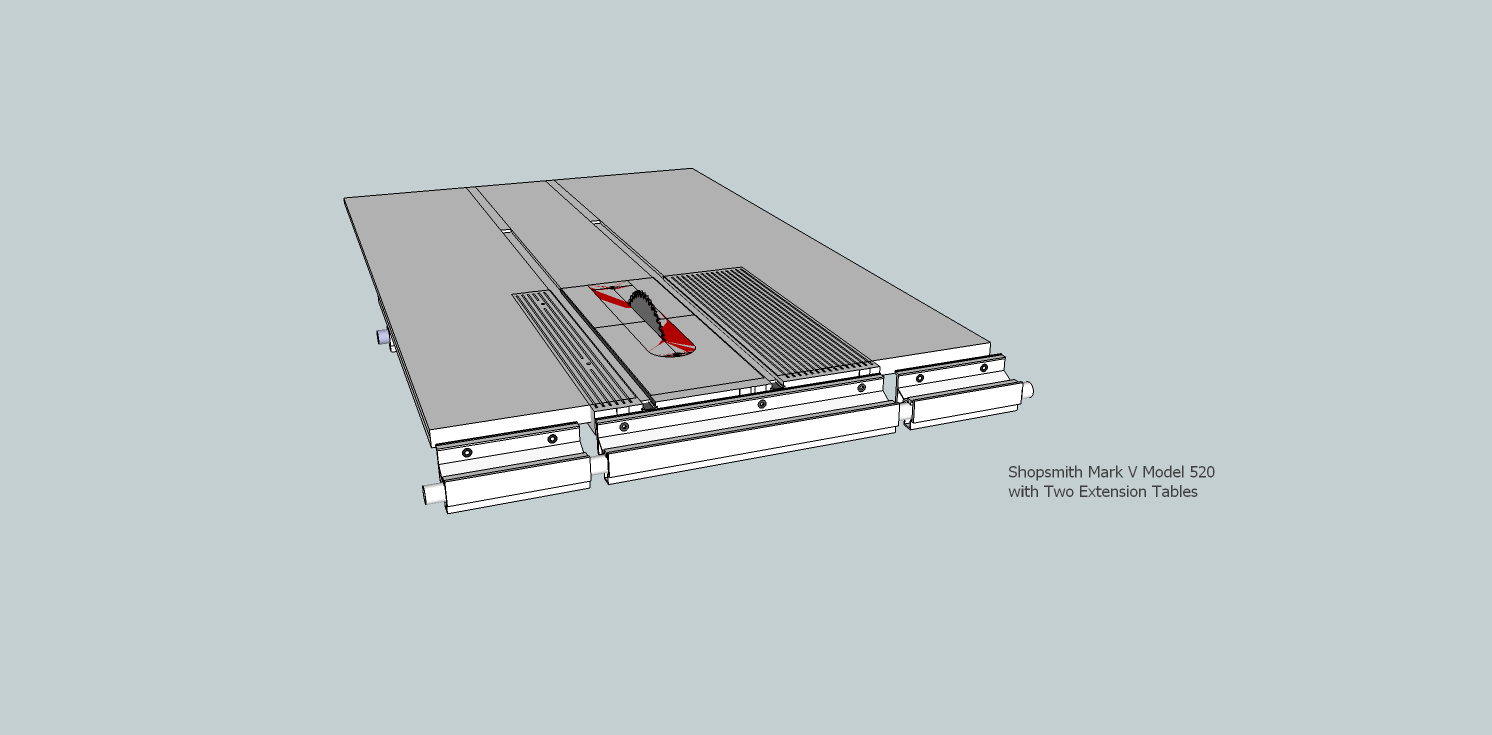

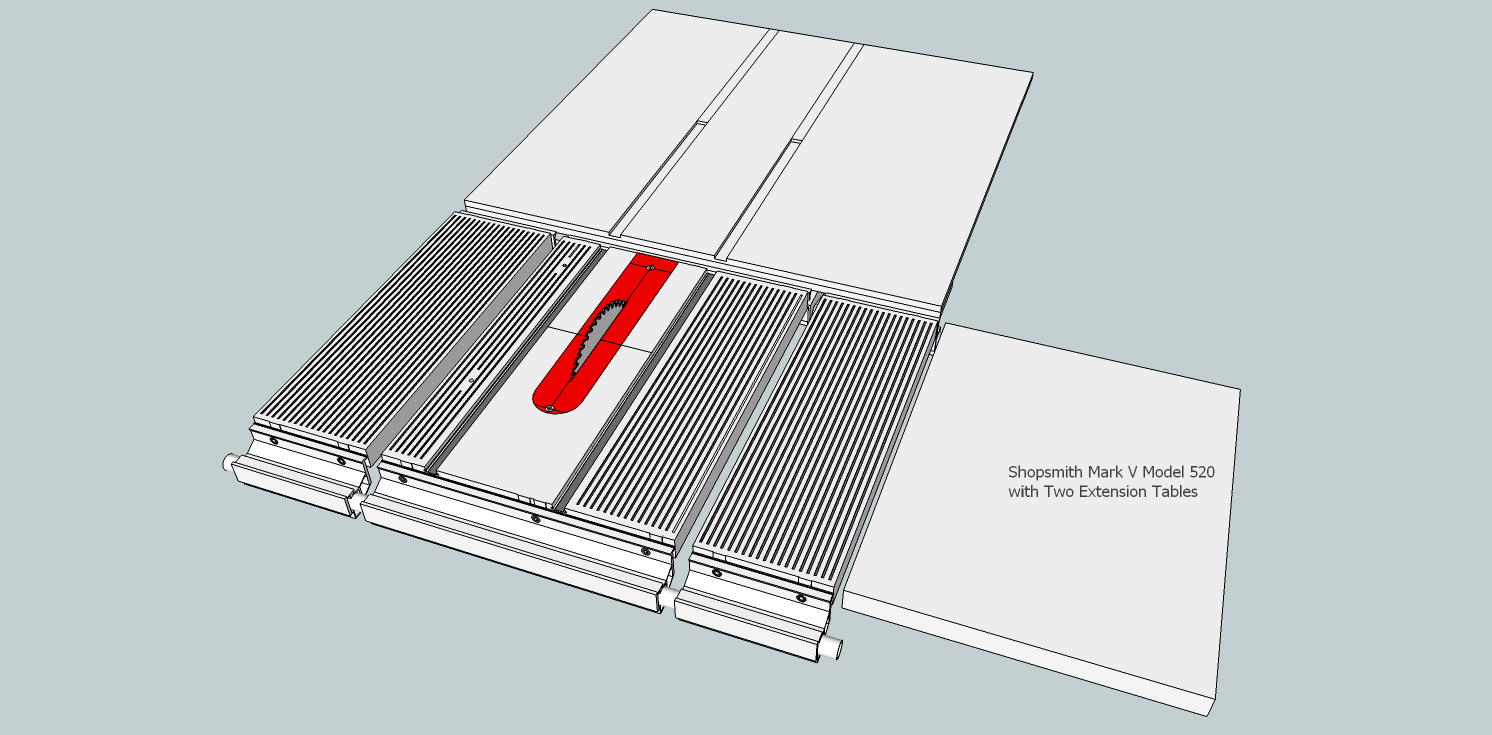

I would like to expand the size of the main table with 2 adjacent floating tables using the connector tubes AND have the benefit of the OFT at the same time.dusty wrote:...I do not understand why you woud want to eliminate the plunger in exchange for an extension tube?

Understood. Never thought about the interference produced by adjacent tables. Maybe it is time for a home made bracket. My OFT attaches using an extension tube. If I had 14" longer extension tubes, I could do what you are proposing.bigmoguls wrote:I would like to expand the size of the main table with 2 adjacent floating tables using the connector tubes AND have the benefit of the OFT at the same time.dusty wrote:...I do not understand why you woud want to eliminate the plunger in exchange for an extension tube?
Need for "the wings" while using the OFT would be the driving force for me.

Dusty, your table with wings looks brilliant, but how would it attach to the 520 table? What would the underside look like?
Re: Outfeed Table
looks like the one with wings would be supported entirely by the main table front and rear extensions tubes. Correct Rusty? This would eliminate the need for the support from your earlier design (which built and have really enjoyed using).

Yes, the OFT would be mounted on the rear extension tubes (right at the rear corners of the main table).
In the concept drawing, I see I left the front rails but I don't believe they would be there. I am not eveb certain that the OFT Wings would need support at the infeed side. The weight of a work piece would be supported by the main table. The wings just give a little support. But maybe. Remember, this was nothing more than a concept drawing.

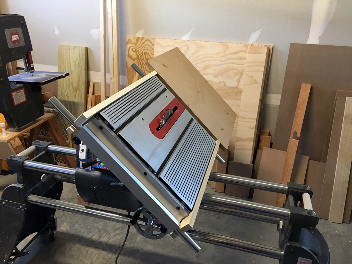

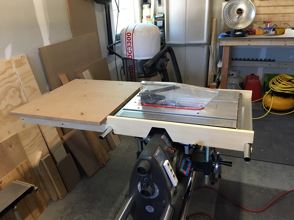

Thanks to all for this conversation and all the ideas, and thanks to iadk for starting the thread. After looking at all the options for the 520 table (which has its own outfeed table connection challenges because of the solid rails instead of the tubes), I decided to go with a modification of a design that Berry Conway posted in the general woodworking forum back in 2012. I still need to cut the dados for the miter gauge, and I have to sacrifice a few inches of possible fence positions due to the front supports, but it goes on and off easily and lets me tilt the table for bevels, add extension tables, etc. Pretty easy design. The most likely annoyance will be the fence positioning, but I'll see how often that becomes an issue. Anyway, this will work for now.

- Simple outfeed table design
- Outfeed for 520 table.jpg (691.25 KiB) Viewed 27719 times
- Outfeed adjusts and tilts with main table.
- Outfeed for 520 table tilted.jpg (725.13 KiB) Viewed 27719 times
Re: Outfeed Table
I guess the wood rails are up against the table so the out feed table does not move side to side.kkoyle wrote:Thanks to all for this conversation and all the ideas, and thanks to iadk for starting the thread. After looking at all the options for the 520 table (which has its own outfeed table connection challenges because of the solid rails instead of the tubes), I decided to go with a modification of a design that Berry Conway posted in the general woodworking forum back in 2012. I still need to cut the dados for the miter gauge, and I have to sacrifice a few inches of possible fence positions due to the front supports, but it goes on and off easily and lets me tilt the table for bevels, add extension tables, etc. Pretty easy design. The most likely annoyance will be the fence positioning, but I'll see how often that becomes an issue. Anyway, this will work for now.
Ken
Why not move those rails out further and use spacers level with the SS table so you can use the full width of the fence?
