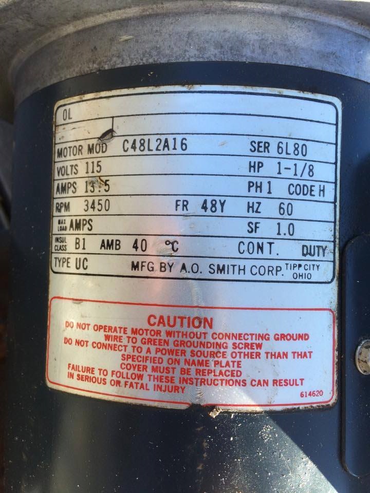

He can reply with specific information ONLY if you provide more detail about the motor.

Here is the shot of the motor itself.
- This is the motor to my machine.
- motor1.jpg (173.1 KiB) Viewed 3342 times

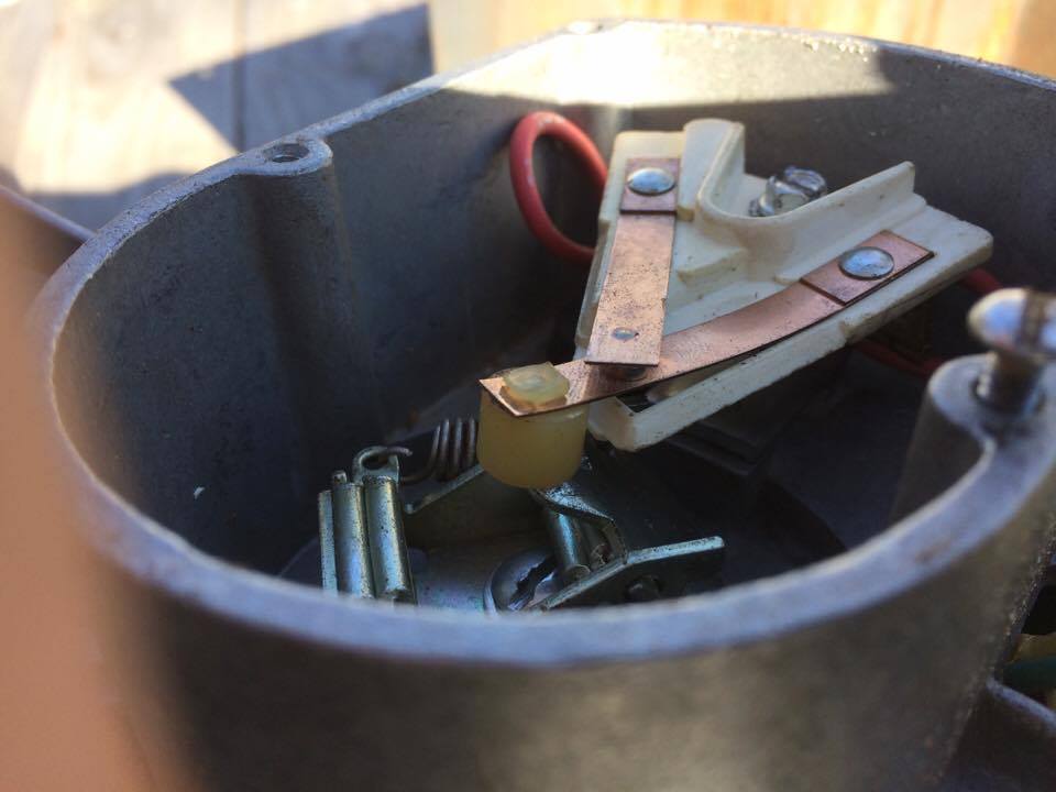

This is my C Switch
- and the swich I have in mine.
- contact1.jpg (49.19 KiB) Viewed 3342 times

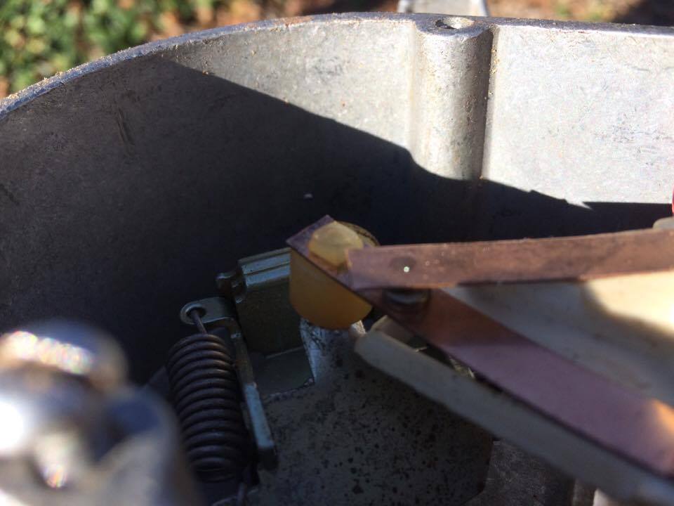

Pic f the contacts and how they sit.
- contact2.jpg (54.94 KiB) Viewed 3342 times

When the start contacts 'close', is there deflection of the leaf spring(the strap the contact is on)? That extra motion is called 'wipe' and is an indication that the contacts are actually pressing against each other. If they look like they are merely touching(maybe) thay may not be making electrical contact.
No apparent burning is a good sign.
Creeping is NOT good. It is however an indicator that the contacts may not be making(the start circuit is not complete). Another possibility is a terminal on the start capacitor may have become disconnected.

I apologize, Im not sure I understand. With no power to the motor at all the contacts are touching. and theyre touching pretty good. I havent observed them while attempting to start it.JPG wrote:When the start contacts 'close', is there deflection of the leaf spring(the strap the contact is on)? That extra motion is called 'wipe' and is an indication that the contacts are actually pressing against each other. If they look like they are merely touching(maybe) thay may not be making electrical contact.
So if I may lets back up. Should the contacts be touching under no power at all If so, should they be pretty tight against one another? Theyre pretty tightly pressed together. It would take a bit of centrifigul force to get that lever to get low enough to break the contact.
EDIT: I checked and as far as I can tell there is contact. The capacitor contacts look fine. I did note that the wires were warming up. But no smoke or anything of that nature. (If that helps indicate anything)
I made an attempt at playing with the bending of the arms on the C switch, it seems to have made no difference.
Also, of note, and I apologize I did not mention it. I am conducting these tests without the motor in the machine. The motor and the cover are completely removed as well as the switch (Which is out of the body of the machine but still attache of course to the motor.) if that makes sense.

Re: tripping breaker
Yes it makes sense.
We have reached the point where visual inspection is not revealing any clues.
That takes us back to measuring resistance etc..
Harbor freight often has a multi tester on giveaway.
The closing of the contacts would be indicated by a near zero resistance reading.
The start winding resistance would be a few ohms.(<10)
Checking the capacitor is more tricky.
