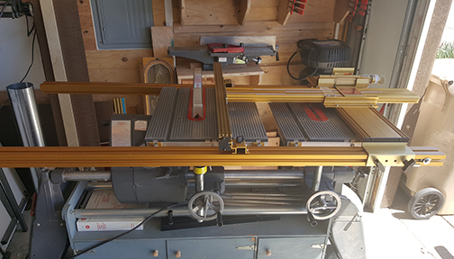

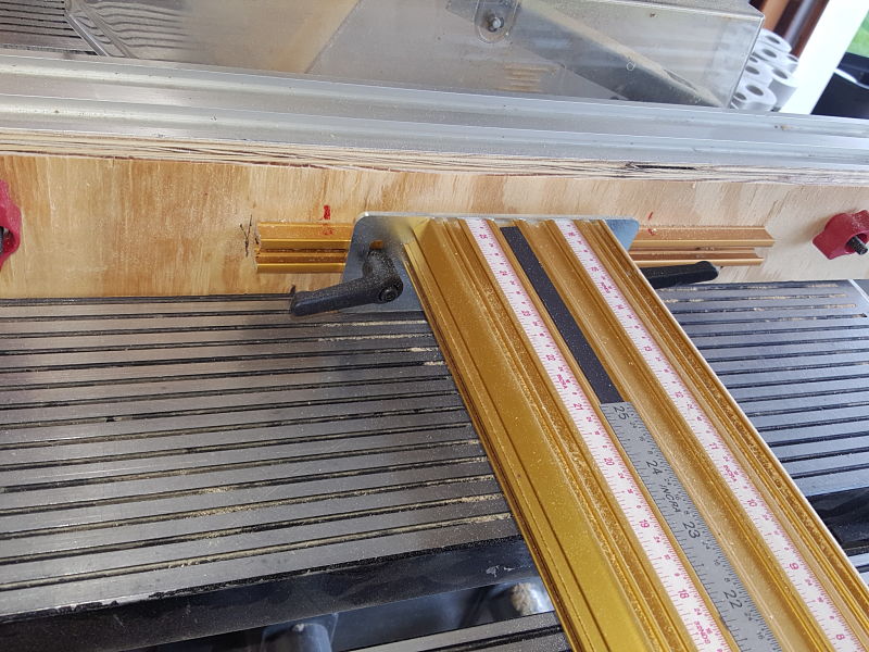

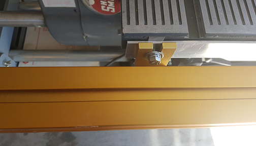

RFGuy here are a few pictures of my install. Any questions I will be glad to answer. I have two carriages on mine and to raise and lower is easy. I also cut down my rails to 65"s instead of the 72" that it comes. May shorten them some more down the line.
Vince

You just need to run a belt around the two carriage wheels so you can turn one and raise/lower both simultaneously.
