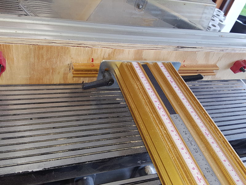

Here's a little twist on the Incra fence... I generally reverse this set up and use on the left side of the blade facing the right for a router table, but it can also be used as a table saw fence. The parts here are from a Craftsman 22811, which is modeled after the Ryobi BT3100. I just mounted some of the Ryobi rails on the SS. The table the Incra LS is mounted to is the craftsman router table, which has a couple of 3/4" by 3/8" miter slots.
Again just a little twist on things. I generally break down larger panels with a track saw, and use the SS for cuts under 18 inches or so. With that said, the stock ryobi fence suits me fine, and I like it much better than the stock 501 that I upgraded from.

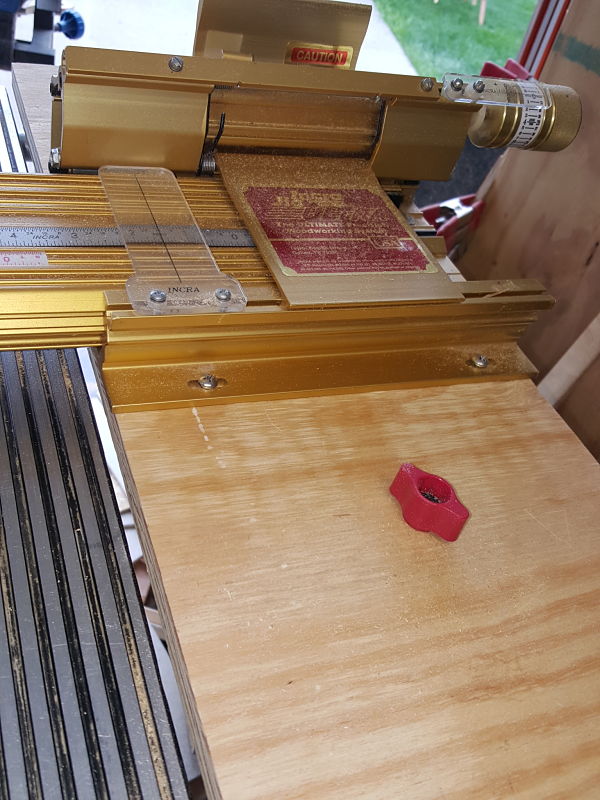

RFGuy here are a few pictures of my install. Any questions I will be glad to answer. I have two carriages on mine and to raise and lower is easy. I also cut down my rails to 65"s instead of the 72" that it comes. May shorten them some more down the line.

You just need to run a belt around the two carriage wheels so you can turn one and raise/lower both simultaneously.

I picked up a used Incra 25 inch Ultra recently. I found the instructions for the SS Incra LS on Incra's website. I mounted the base to a piece of 3/4 inch plywood that I fastened to a floating table as the instructions explained. I used a piece of 3/4 inch plywood to mount a piece of T-track to attach the carriage to the SS fence using a couple of elevator bolts in the fence side T-track.

Nice use of what you have. Enjoy the better fence and repeatability!
