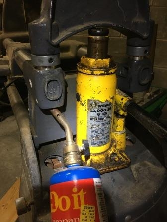

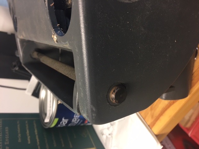

Update:
I have had to resort to the aforementioned Gorilla tactics as shown below(pic 1). One side is loose, other is not. I applied pressure with the Jack, Heat, whacked it with the rubber hammer some more. Also applied lifting pressure on the offending collar with a pry bar. No joy.
It has been sitting for over 24 hours under pressure with no improvement.

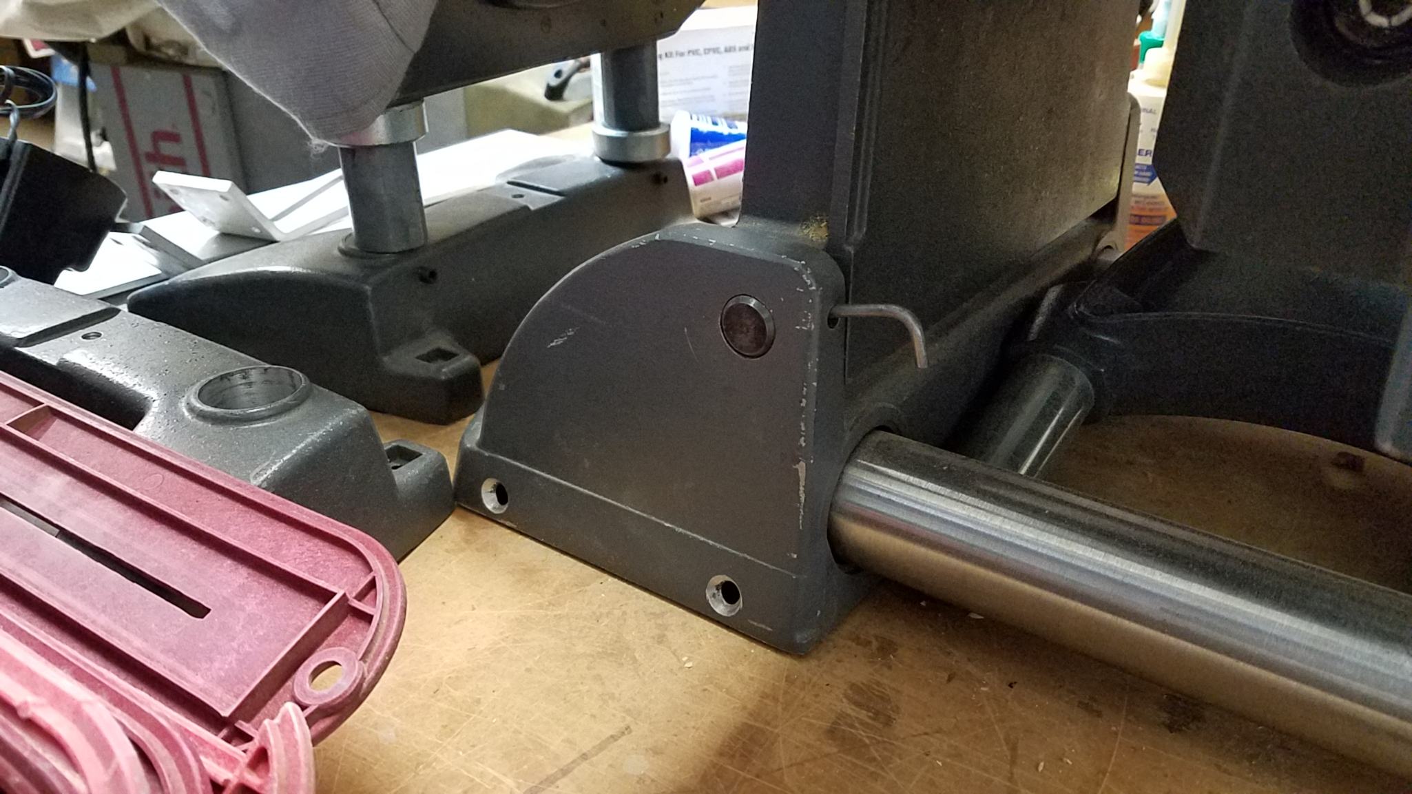

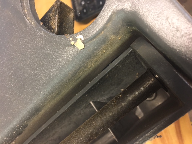

I have not tried to push the Tension Pin(pic #2) thru because i see anyplace for it to "go", or drop out (pic 3). I looked at the MK V schematic and it doesn't even show the roll pin.
Re: Tailstock stuck in MK V
Believe me, if you punch the pin clear through the hinge pin, the pin will drop out. The only way that it would not is if the casting is full of crud to prevent it from moving. Gravity works.
Take a real good look at the pin (that you are attempting to remove) and then roll the hinge pin 180° so that you can inspect the other end. What is see in picture #2 is not quite what I expected. That pin looks to be a bit mushroomed.
There was a rule on the battle field requiring that the leader always have an alternate plan of attack. Yoy might want to remove the casting from the Way and Bench Tubes.

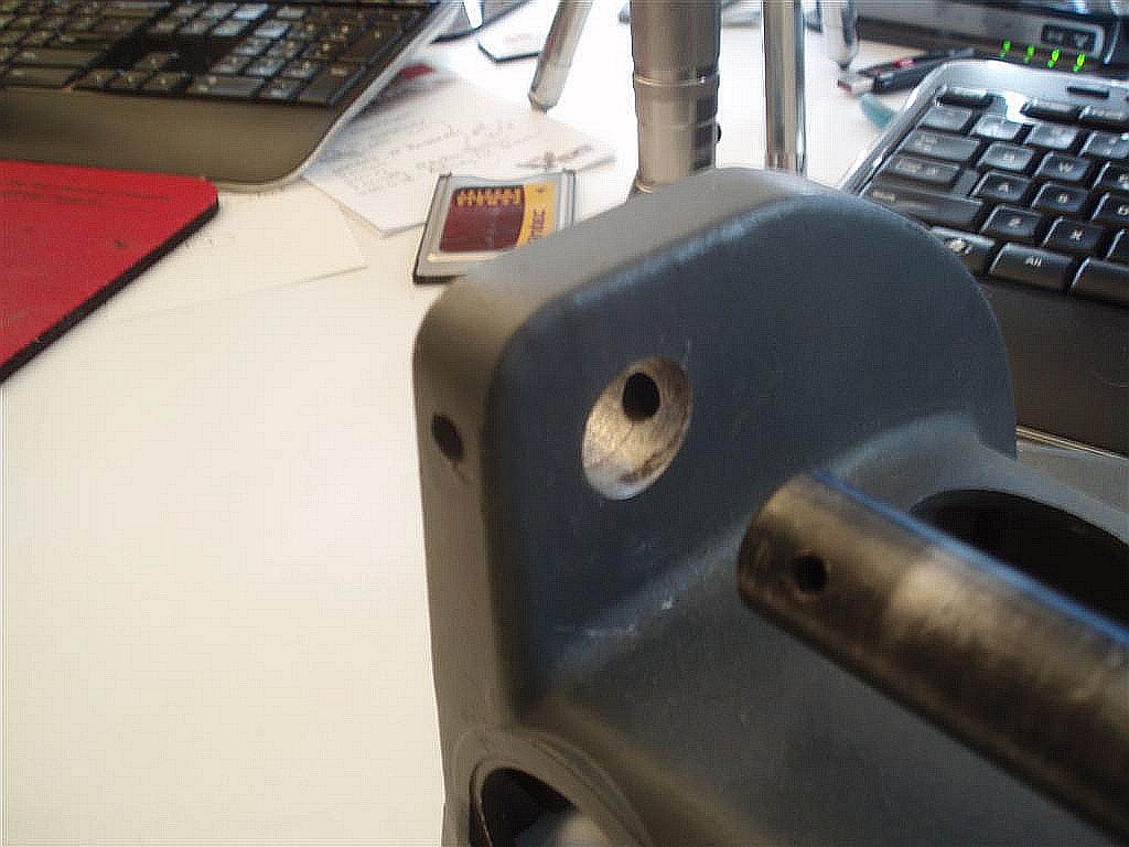

Rest assured, it IS there.
HINGE PIN BLIND HOLE.jpg (94.7 KiB) Viewed 3555 times
Pix 1 appears to have the jack handle side 'loose'(higher than
If so pressure needs to be to the stuck side only. Furher 'jacking' as set up will cause it to become more cocked and bind more.
I think wedging between the collar and the base is appropriate. Start with wedge on the 'outside'(away from the 'loose' post).
Post by Hobbyman2 »
This might sound like another gorilla tactic but have you tried tapping it down just to loosen it?
When you are applying pressure with the jack are you sure you are not pushing it up on a angle and binding it worse?
I notice you are adding heat to the area of the tubing , this can cause the tubing to swell and not the hole , try wrapping a cold wet rag around the tube and just heating the mount around the tubes?
Force from the bottom side. Probably impact force on the end of the stuck tube.
I would have torn the machine down so as to be able to do that without all this fuss and heat. I do understand that not everyone enjoys a good tear down and rebuild like I do.
I agree Dusty on all accounts.
I think we should be dealing with two parts.
All that other stuff is in the way, and subject to unintentional damage.
