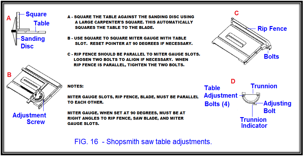

Hobbyman2,
https://www.shopsmith.com/ss_forum/view ... 69#p210669 titled “My method to the alignment process” was a thread I started in April of last year after many dead horses had been beaten on this subject, yet newer forum members for whatever reason keep asking the same answered questions, and some seem to do so just to make others irritable.
Do these folks just not read any of the topics in discussion before asking the same questions? I try to be patient with newbies, but in reading some of the questions, it becomes more apparent that some newbies have Shopsmiths, and some do not.
That’s ok, but if one will just look at what is contained in the first two sticky posts (always at the top) of the Maintenance and Repair Forum, they will find that MickyD in “Everything Mark 5 / V - Technical info, documentation, links”, and JPG in “Newowner Information” have provided links to the relevant areas, that will answer the questions.
Subsequently, in January of this year, at the request of a number of members, I created and added a PDF document "My Method to the Shopsmith Alignment Process" to documents that may be downloaded in the first post in the Buying a Used Shopsmith Revisited thread, as well as posting in in my Google Drive. That PDF document was announced in http://www.shopsmith.com/ss_forum/viewt ... 88#p226688 and contains information from the previous thread responses and is contained in my contributions to collect and organize answers for newbies and seasoned owners alike in the thread “Buying a Used Shopsmith Revisited” https://www.shopsmith.com/ss_forum/view ... 90#p185690 which has that document link, presently the 2nd one down, which could change as I add material.
Last year in restoring manuals for the 10ER written almost seventy (70) years ago, I found that MAGNA, Hans Goldschmidt and R J De Cristoforo had published alignment instructions for the 10ER before I was born, instructions that mirrored in many ways what I had concluded independently about alignment.
I point you to that by the figure I attach from it, and re-direct you and anyone else to the discussions and comments in the posts above and those that preceded them. We aren’t beating a dead horse, or changing horses in mid-stream on this topic; The stream dried up decades ago, and the horse has decayed into dust for many years.
Everett
FIG 16.png (83.04 KiB) Viewed 4570 times

Thanks for the re-share Everett! Looks simple enough. Looks like the manufacturer's also did not trust the outside edges of the mark V 500 table as reference surfaces for square.

Thank you Everett
I bought my SS used ,,,with out any of the documentations ,,,, that did not bother me because like I said ,,,,,I have been around the block and know what has worked for me over the years , what I have done has provided me with the best this machine has to offer ,that said I will re do every thing and do it this way,,,, and then check it all again,, to verify the results , I will also print that and frame it .

I'm wondering if shopsmith would allow us to publish the section out of the manual on how they tell us to do the set up of their machine?
I don't believe it is presently online, or at least I don't know where to find it if it is.
This is in the "B" section in the current manual, in mine it starts at B-19. It covers a lot of good information and has plenty of detail to get a machine aligned.
It should be everyone's starting point. Later you might find a few changes you like to make and that is fine. I know I have but I've used these methods for year and years and they do work. I now use a master plate rather then a blade as an example but the saw blade does work just fine.
