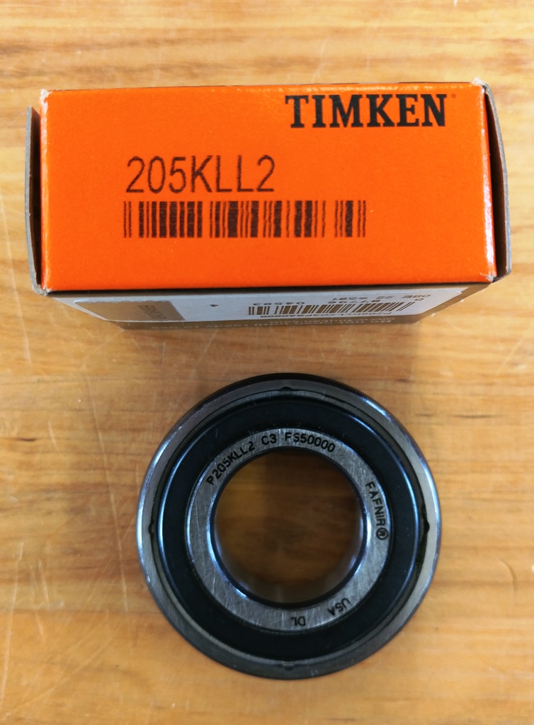

Perfect Everett. That is very definitive and right on point. It really illustrates why you have to know what you want beyond the base number on the bearing.
When I ordered bearings for my 10ER refurb I stated that I wanted original Fafnir bearings but did not state that I wanted C1 (C0) clearance. What I got was C3. In this case the full bearing number is on the bearing but that is not always the case. It was not on the old bearings I removed. So you don't know what you have other than the basic size and probably the type and number of shields/seals.
