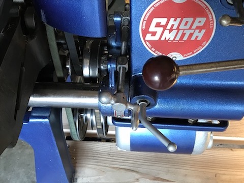

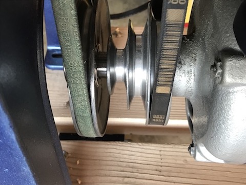

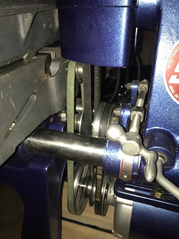

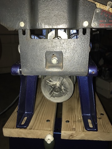

This is my setup with the speed changer. hope this helps!
Pulley setup 10ER with E4 Jointer and Speed Changer.
pulley setup 10ER with E4 Jointer and Speed Changer.
