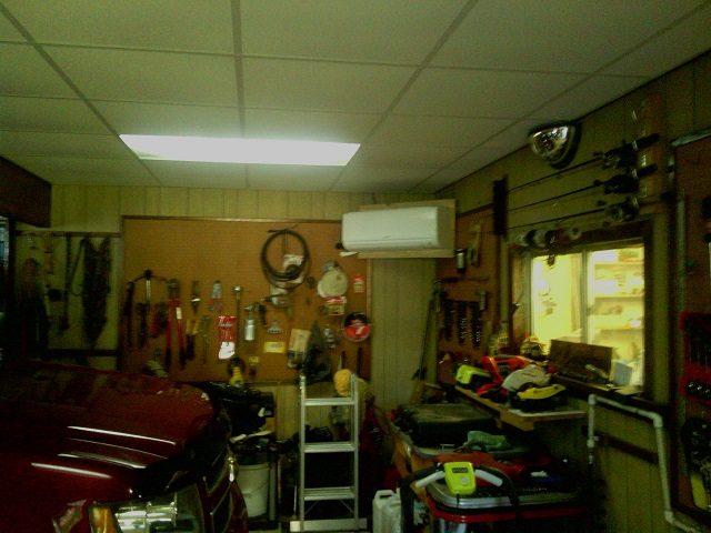

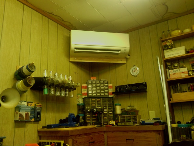

Well all said and done now, cost just over $4200 didn't get the 10% but did get the 5% and 12 month no finance charge, which works out about right since the 5% is on the entire amount and the 10% would have been on the cost of the unit only, (about half the total) no labor etc..of course had to file a complaint with the AG office to get it..funny how they didn't want to give me any discount until I filed a complaint..lol...then I get a call two days later offering all these discounts...the 10% is a non starter, they didn't budge off of that, it is "In Store only" end of story, but the other stuff mysteriously popped up and they gave me a $200 gift card for my troubles, saying it was for customer appreciation ...ya ok. So ended up OK I guess. A few pics, decided I didn't want to give up any peg board space if we did the standard center of the wall install, so I built a caddie corner mounting wall for the shop side and the garage side piping it straight out the wall gravity feeding the drains. Both units are opposite each other, couldn't believe it when the installer said he had never seen it done this way...Whattt...why not..lol...I kinda over engineer these caddie wall...pretty sure I can hang an engine block off these walls...lmao...22 Lbs AC unit, not a problem. Looks much better and I think air flow is better, didn't lose any peg board space and so since I now need to close off the shop from the garage, because frankly will very seldom ever use the garage side, I put in a barn door slider in the door way, no choice, because my DC is there couldn't close the door anymore, never was problem before..lol..door hadn't been closed in ...oh never...lol...
LUV this system, temps have been in the high 90's and sitting in my shop 75 degrees not even working hard...gotta love that...hoping the heat will work as well this winter
.<br />.
You can see where I moved stuff off the peg board in prep for the regular install..would have used up half my peg board, and the shop side was even worst...didn't like that, this is a better solution<br />..
