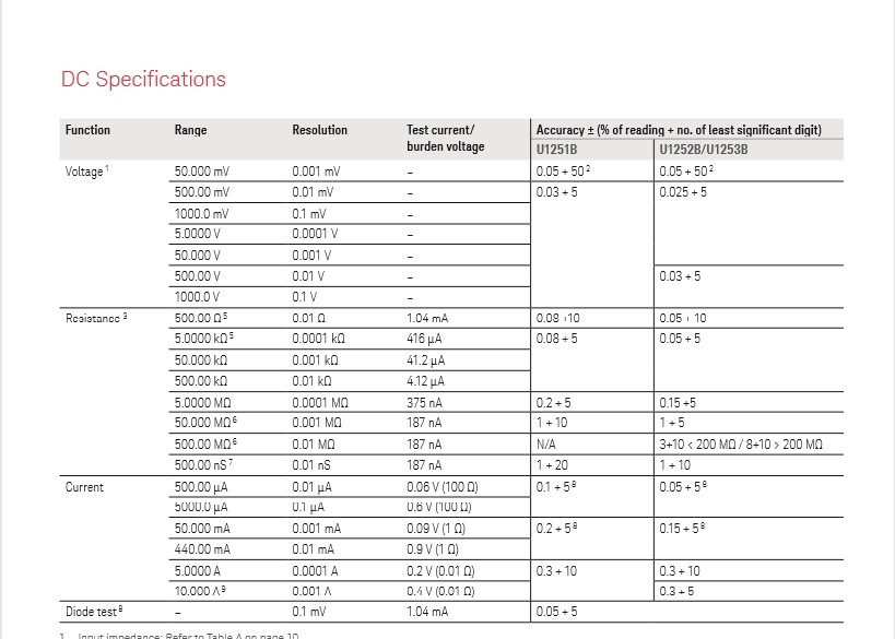

Re: Bosch Digital Laser
JPG, thanks for taking my comments in stride and having fun with it (as they were intended). I love your +/-LSD comment instead of +/-LSB. As an Analog guy, that is just too funny.JPG wrote:Digital = all bets off!(±LSD)
More to the point, an accuracy that is a % of the reading by definition will be directly related. However it would be linear though not constant.
Resolution would I assume to be constant over the range(scale marks if analog).
The quagmire comment was because this resolution vs accuracy babbling has previously occurred.
When digital the least significant digit will always introduce a ± 1/2 factor.
The resolution is a function of the display.
The accuracy is dependent upon the analog to digital conversion as well as the analog stuff itself.
BUT 'we' digress.
P.S. I do not like cats dead or alive.(unless they are still kittens)
