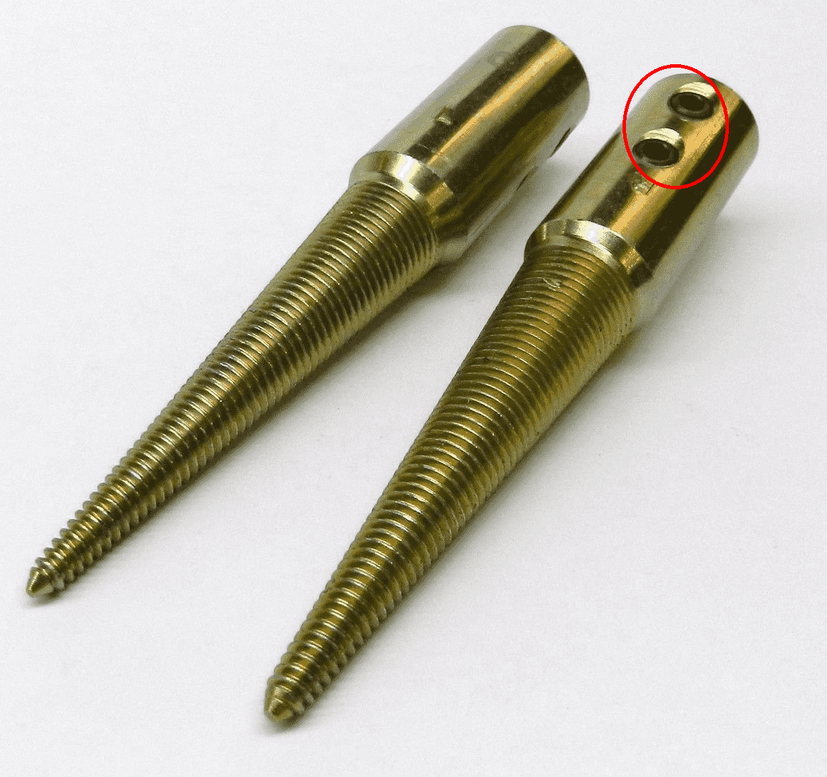

Also in a previous post someone identified a Morse taper extension. I don’t think it is that. It looks more like a spiral buffing wheel mount where the fabric buffing wheel slides on and off and is pulled inward by the spiral. If it is that, there are two types right hand spiral and left hand spiral for which end of the headstock you attach it.
They are common on buffer motors with shafts at each end.

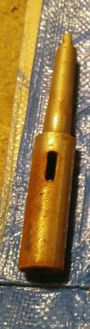

This looks like a morse taper adapter (#2 to #1 ???).
Now about the current state of the Mark 2 - looks great!!!!!!!

I was looking at it on my cell phone. You are right. The slot is a give away. I thought it was the adjacent setscrews, but blown up you are correct it is a slot, and therefore a Morse Taper extension.
Everett

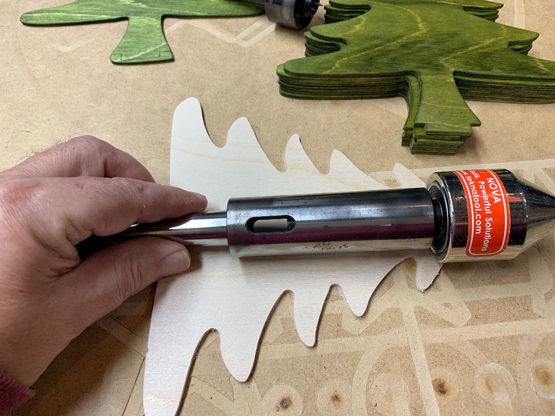

A Morse Taper Extension allows more flexibility with the use of lathe drive centers, revolving centers, drill chucks etc.which fit a No.2 Morse Taper. This type of adapter extends the accessory about 3-1/2" from the headstock or tailstock, providing more manipulation of turning tools, and at the headstock or tailstock. This allows deeper access turning bowls and similar operations.
A live center or other #2 Morse Taper on Shopsmith tailstock can be moved away from the tailstock 3-1/2" providing that access, and the Morse Taper Drift Key inserted into the slot in the extension provides a simple way to separate the center from the extension when finished.
See attached.
Everett

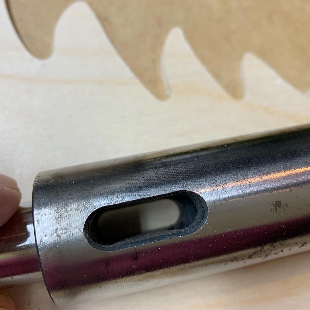

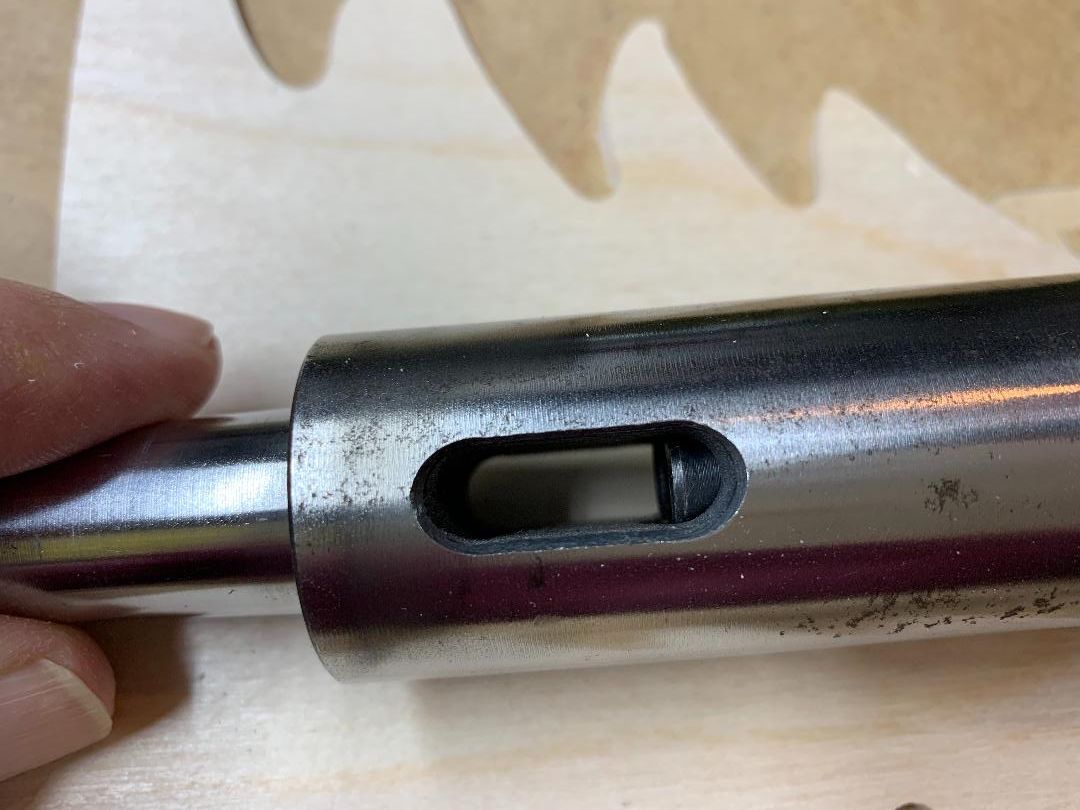

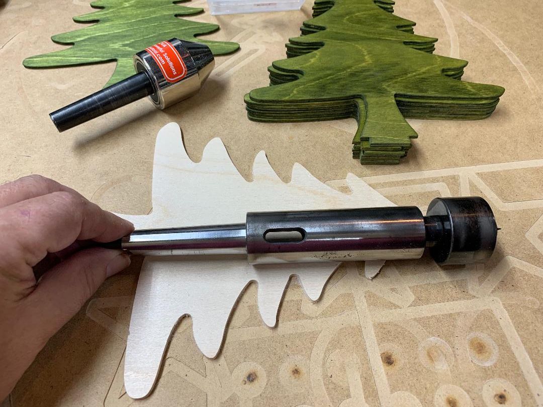

A warning here. If the center you insert doesn't go in far enough for the drift to touch then it will be tough removal. Typically that means that it doesn't work with shopsmith centers.
Here is an example of how it should be, first the over view then the close up showing the tang in the opening.
Now with the shopsmith live center and a close up of nothing showing up for the drift to touch.
Hope this helps.

reible wrote:A warning here. If the center you insert doesn't go in far enough for the drift to touch then it will be tough removal. Typically that means that it doesn't work with shopsmith centers.
For this dilemma, one keeps a few ball bearings that will slip into the tang wedge slot and thus effectively extend the tang into the slot area.
