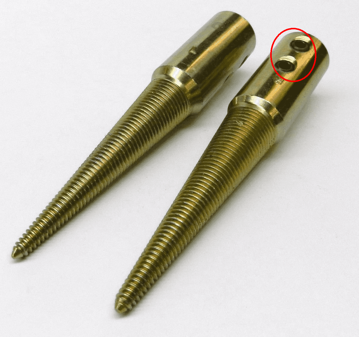

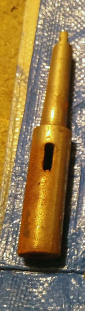

With regard to the base and wanting something more you might consider mounting it like a shop deputy to a work cabinet. Just search for shop deputy on the main site and you’ll see how you might proceed on something with your Mark 2.
Also in a previous post someone identified a Morse taper extension. I don’t think it is that. It looks more like a spiral buffing wheel mount where the fabric buffing wheel slides on and off and is pulled inward by the spiral. If it is that, there are two types right hand spiral and left hand spiral for which end of the headstock you attach it.
They are common on buffer motors with shafts at each end.
Everett

everettdavis wrote:With regard to the base and wanting something more you might consider mounting it like a shop deputy to a work cabinet. Just search for shop deputy on the main site and you’ll see how you might proceed on something with your Mark 2.
Everett
This looks like a morse taper adapter (#2 to #1 ???).
Now about the current state of the Mark 2 - looks great!!!!!!!
Re: Mark 2 Restoration
Posted: Tue Dec 11, 2018 6:36 pm
by everettdavis
I was looking at it on my cell phone. You are right. The slot is a give away. I thought it was the adjacent setscrews, but blown up you are correct it is a slot, and therefore a Morse Taper extension.
Everett

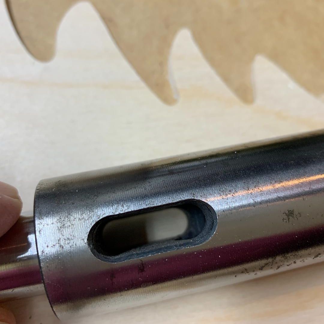

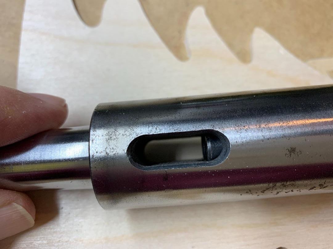

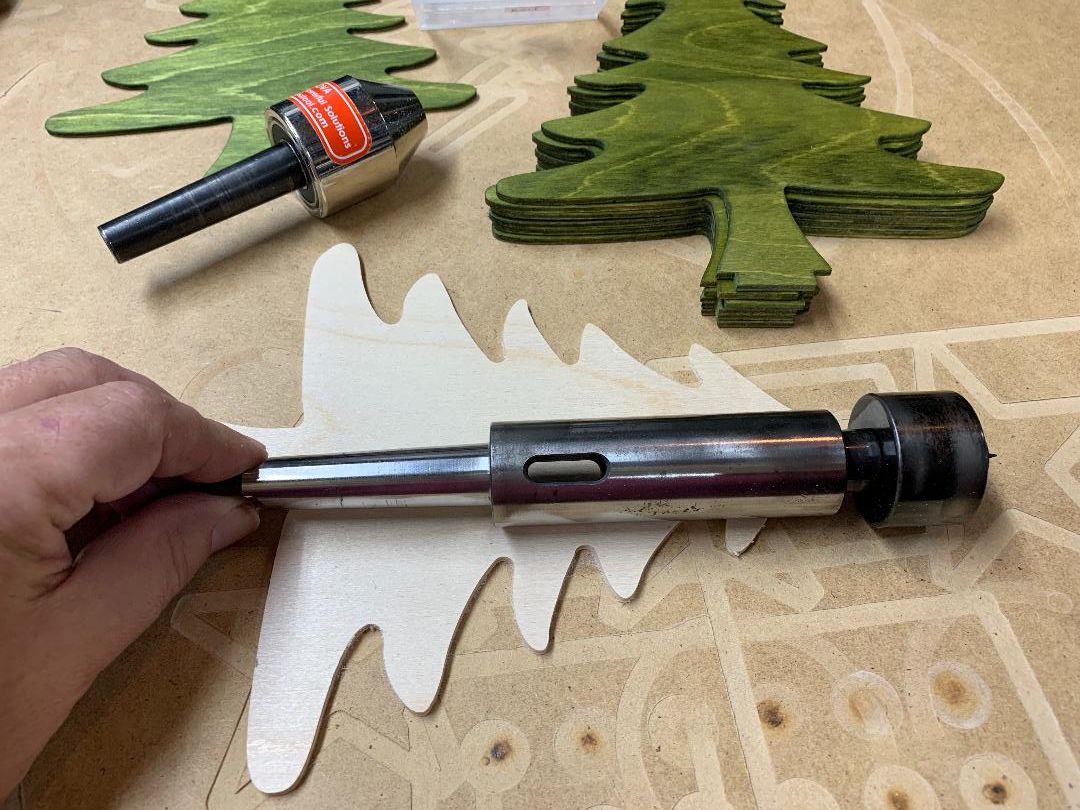

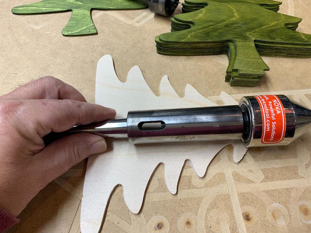

A warning here. If the center you insert doesn't go in far enough for the drift to touch then it will be tough removal. Typically that means that it doesn't work with shopsmith centers.
Here is an example of how it should be, first the over view then the close up showing the tang in the opening.
Now with the shopsmith live center and a close up of nothing showing up for the drift to touch.
Hope this helps.

reible wrote:A warning here. If the center you insert doesn't go in far enough for the drift to touch then it will be tough removal. Typically that means that it doesn't work with shopsmith centers.
For this dilemma, one keeps a few ball bearings that will slip into the tang wedge slot and thus effectively extend the tang into the slot area.
