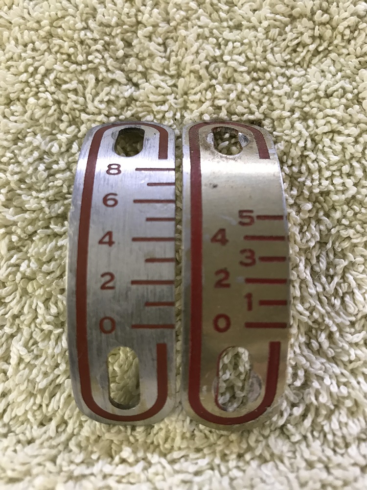

Sorry I am at the end of this conversation but I have a few comments to add from my observations. Ron showed the two types of floating sheaves used in the early to late Speed Changers. I have had 10 speed changers with the Model 10's I have purchased that have come with S/N range of 1077 to 76928. Being an accessory I believe most were purchased later than the original Model 10E or 10ER purchase. None have had the early floating sheave Ron shows in his photos but I have had 3 with the 0-8 scale. I believe these changes came at separate times and for different reasons. The two scales shown below have 0 to 5 equally spaced between both scales and 6 - 8 are above.
Early and Later Speed Changer Scales
Speed Changer indexs r.jpg (310.21 KiB) Viewed 15590 times
The changes made to the Speed Changer during it's production were the sheaves for the Floating Pulley Assembly (see Ron's pictures), the Scales from 0 - 8 to 0 - 5 (shown above) and the retaining ring that holds the floating pulley arm on the main/base casting. On a properly adjusted Speed Changer/Floating Pulley Assembly, no matter which sheaves it had, only the 0 to 5 numbers on the scale would be used. It is why the speed charts for it only reference 0 - 5. The 6 to 8 on the early scale was not used and could have caused some of the breakage of parts on early Speed Changers when users tried to get theirs to go to those higher numbers for a faster speed. I believe the change of the sheaves was to keep users from re-adjusting the outer sheaves allowing the belt to touch the sleeve and lubrication on it. A properly adjusted Floating Pulley Assembly of the later version does not allow the belt to touch "sleeve" parts either.
These are the important things to remember when using the Speed Changer. When installing the Speed Changer the 2 washers should be on the extended set screw between the changer and the headstock. The "jam" nut should only be finger tight and loosened when moving the headstock if any binding occurs. The springs on the Adjusting Screw Assembly should never be compressed by cranking. They are there to act as "shock absorbers". Read the instructions to make sure the Speed Changer is properly installed and set-up.

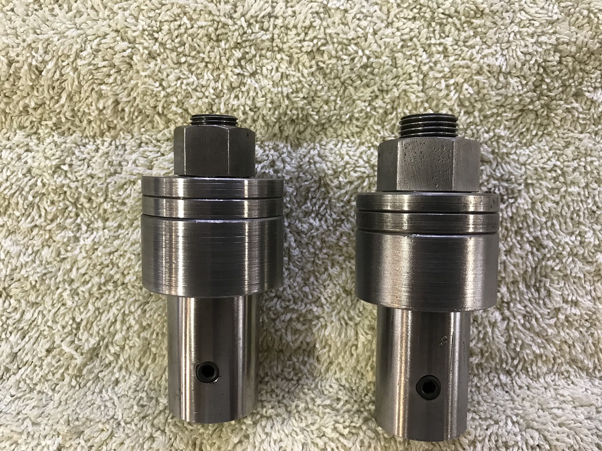

And here are the interesting arbors.
I wouldn't be surprised if some or most of these parts are Craftsman, as there's a lathe faceplate and several chisels that are Craftsman.
The threading is 1", 7/8, 3/4, and 5/8". The 1" arbor was partially threaded into the face plate that's pictured. There's nothing too peculiar about the 5/8" arbor except someone put a collar with a set screw on it. They must have just used it as a spacer.
The coupler shaft is 1" O.D. and 3 9/16" long.
I don't know if any of these are Shopsmith, or if they were just compatible, but they could come in handy for grinding wheels or something.ImageImage

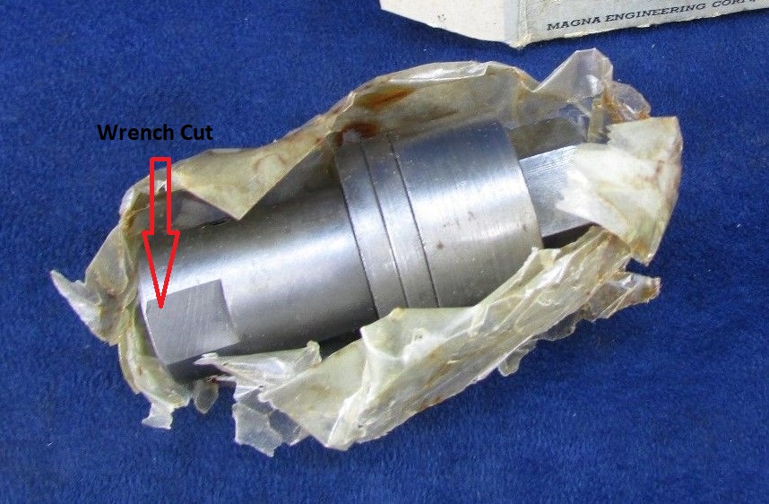

Looking at the 4 arbors my first question is do they have a 5/8" bore to go onto the Shopsmith's spindle? All arbors, chucks and shaper spindles, made by the manufacturers of the Shopsmith for use with it, have a 5/8" bore and a single set screw to attach them to the 5/8" reverse tapered spindle of the quill. The first 1/2" and 5/8" arbors did not have the cuts in the sides of the base for using a wrench. These arbors had a 3/4" machined spacer, two machined washers and a nut. All of which fit on the threaded shaft as seen below.
1/2" Arbor on left, 5/8" Arbor on right
102-35X and 126-1X r.jpg (551.05 KiB) Viewed 15297 times
On the left is the original 1/2" Arbor and on the right is the original 5/8" Arbor. The average length of the threaded shaft on the 1/2" Arbor is 1-5/8" and on the 5/8" Arbor is 1-15/16". Later the lower sides of the base had cuts onto them for using a wrench to help tighten or remove the nut. Pipe wrench marks are common on these early arbors. Below shows the 5/8" Arbor with the wrench cuts.
5/8" Arbor version 2
126-1X version 2 info.jpg (201.16 KiB) Viewed 15297 times

Yes, all arbors/attachments that I pictured have a 5/8" bore and a single set screw. I don't think much of the selection pictured is Shopsmith. No idea what the 1" O D. shaft is for, I cleaned everything up with evaporust and it has no set screw marks on it.
After digging through the box, however, I also found a Shopsmith 1/2" router chuck with a 3/8" bit mounted, and there is a lathe center mounted on the headstock that I haven't been able to get off yet.
