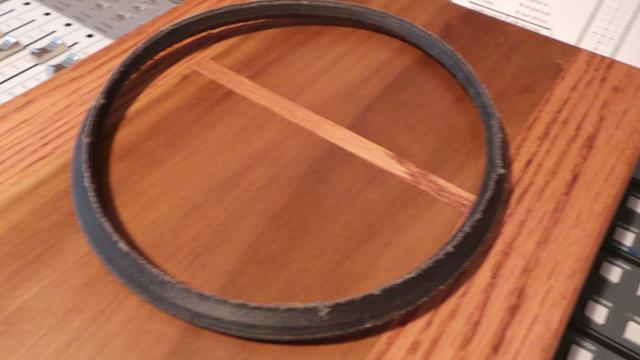

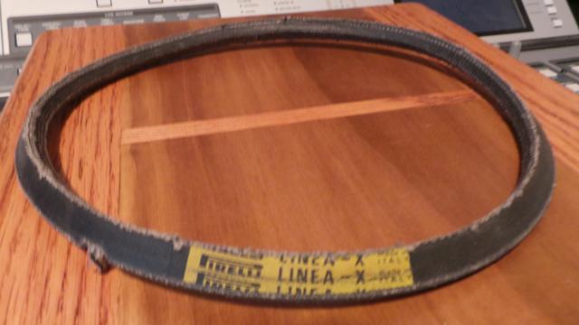

V-belt replacement
Re: V-belt replacement
Assuming you have the correct length and width belt, then setting the high speed according to the book with the belt 1/8" should set the sheaves to the correct position.
Nominal belt length is NOT the od, but something between the od and the belt id. It is the 'effective' length when running over a pulley. I goofed when I said 25.5. I do not know where that first 5 came from(s/b 6).
Yes the reeves drive will accommodate a narrower belt(like when it wears), but the resultant speed range will be altered. i.e. for a given setting of the control sheave, a narrow(worn) belt will ride lower in the idler pulley. The motor pulley will also be responding to the narrower belt by allowing the floating sheave to be closed more. This will result in the belt riding higher in the motor pulley. The resultant speed will be an increase over that attained with the wider(new) belt.
- Posts: 21481
Yup. I agree with all of that. That simply means that when you turn on the Shopsmith and set it to saw speed (as an example) you don't really know what the speed is. It is somewhere in the general vicinity of the recommended speed.
This is true whether you have a brand new belt or one that is somewhat worn and frayed.
Further more, for discussion here or for work in the shop, the "measured" od of the drive belt is as good as any other number you might use for calculations. "Effective" length is to be measured at that location where the support fibers are located. Since that can not be determined without manufacturing specs for 'that specific belt' I use the od.
My belts all measure 26 3/4".
I agree BUT why do we all seem to believe that the belt should ride 1/8" below the rim of the sheave? Are there consequences if it rides closer to the rim? Like say the belt and the rim are at the same level?garys wrote:Assuming you have the correct length and width belt, then setting the high speed according to the book with the belt 1/8" should set the sheaves to the correct position.
To avoid confusion...let us assume that we have the proper belt installed and it is in excellent condition (brand new from Shopsmith).
