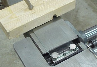

I too started making the alignment jig. I've gottten side tracked on some other non wood working projects, but wanted to post a picture my almost final design (several mistakes along the way I will post later).
3" wide double strength glass, 2 - 3/4" rare earth magnets hot glued at end of the glass. I now realize I should use magnets to also hold the glass plate in place rather than the wood block and clamp in the picture. It's important to put the alignment magnets at the very end of the glass so you can get your allen wrench into the screws.
[ATTACH]75[/ATTACH]
Once I got the system worked out, it sure made short work of getting the knives aligned.

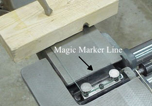

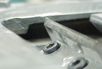

In designing this, I wanted to make sure I placed the jig in the exact same place every time. I first visually determined where "top dead center" was on a knife.
[ATTACH]79[/ATTACH]
Then I placed the end of the glass where the magnets would be over this tdc point. Then using a square I drew a magic marker line on the glass right over the end of the outfeed table. That now becomes the line I use for placing the jig.
[ATTACH]80[/ATTACH]
Once I got this jig configurtion and technique down, it took about 15 minutes to align all the knives. Pretty darn fast.
