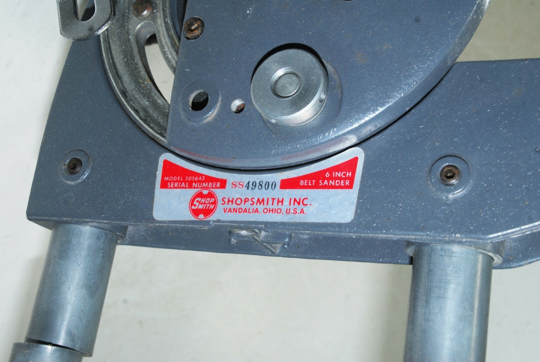

Here's a couple new ones for you Russ. Is the 2989 SN February Ninth 1989?
Belt Sander SS2989.jpg (159.13 KiB) Viewed 26184 times

well for whatever reason the second SN Plate will not post. The number is SS49800. I would assume this one is newer than the one I posted last week. Since the number is higher. Is that correct?

Spooner wrote:well for whatever reason the second SN Plate will not post. The number is SS49800. I would assume this one is newer than the one I posted last week. Since the number is higher. Is that correct?
Exceeded size requirements. :)
Spooner wrote:Maybe this will work.
https://i.ebayimg.com/images/g/-qgAAOSw ... -l1600.jpg
