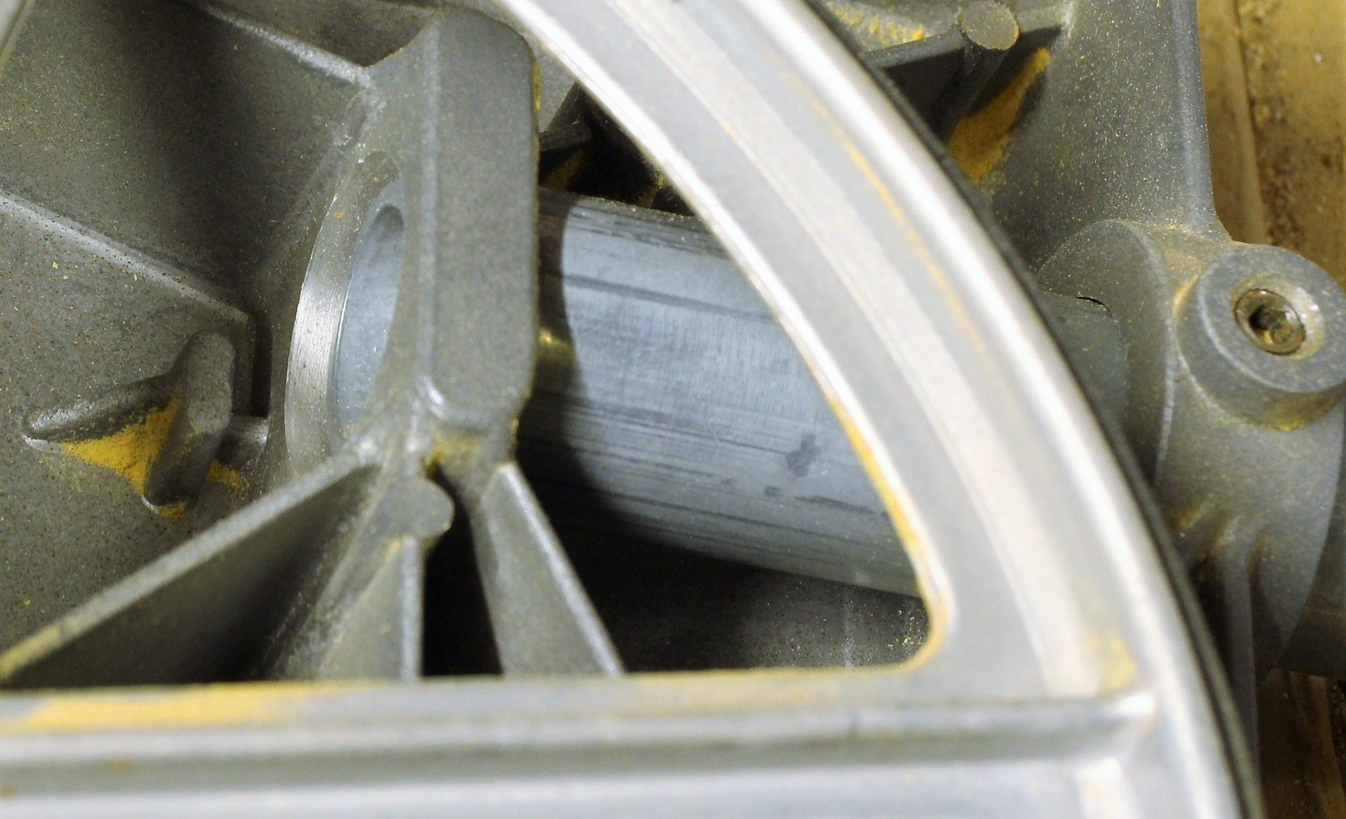

I would like to get back to the Headrest mounting holes but not right now. The picture I included was only meant to convey how much worse the holes looked visually compared to the base. I need to see if I can find a way to photograph what I think the issue is.
These BS eccentrics are new to me, my Magna BS has straight tubes and my Magna Jointer has a completely different design of eccentric. (I'm a couple of years older than them, but they are pretty old.) When I aligned the drive hubs the "new" BS eccentrics did not go all the way into the BS, that was one of the things that I contrasted with the straight tubes. Mine look like this:
Bandsaw Eccentric Tube Mounts
Not only does it not engage the stop, it's kind of marginal on engagement of the upper collar. (There is ~1/8 inch of bevel at the top of the tube and hidden in this photo, but not adding much stability.) Not saying this is good, but it's what I ended up with when I thought I followed the instructions. Clearly, we did not all do it the same way OR do not have the same eccentric tubes. (Dimensions of mine are at the beginning of this thread.)

In an earlier post in this thread, JPG said he did not think the eccentric tubes were long enough at either end. I completely agree, and this (photo) is what I think/thought he meant.
Despite all of the things I didn't/don't like about how the eccentric mounts in the BS compared to the straight tube, I don't think it is rocking up there. I think it would get worse is I fully engaged the tubes in the BS, because I'd lose something like 1/2 inch of engagement in the headrest.

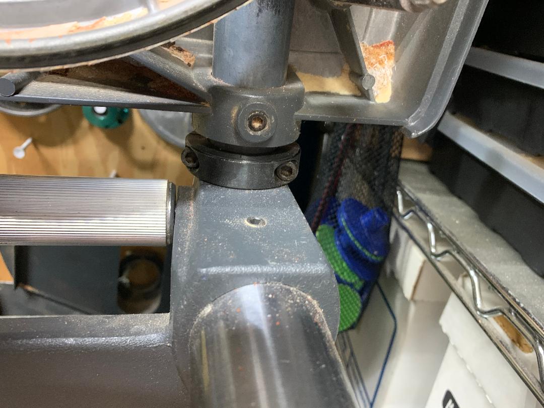

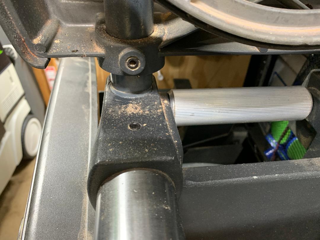

I had a few minutes today so I added a couple of collars to the bandsaw to see if that made much of a difference. Results were just a tiny bit better but not worth the effort, at least on my machine.
collars one on each side
