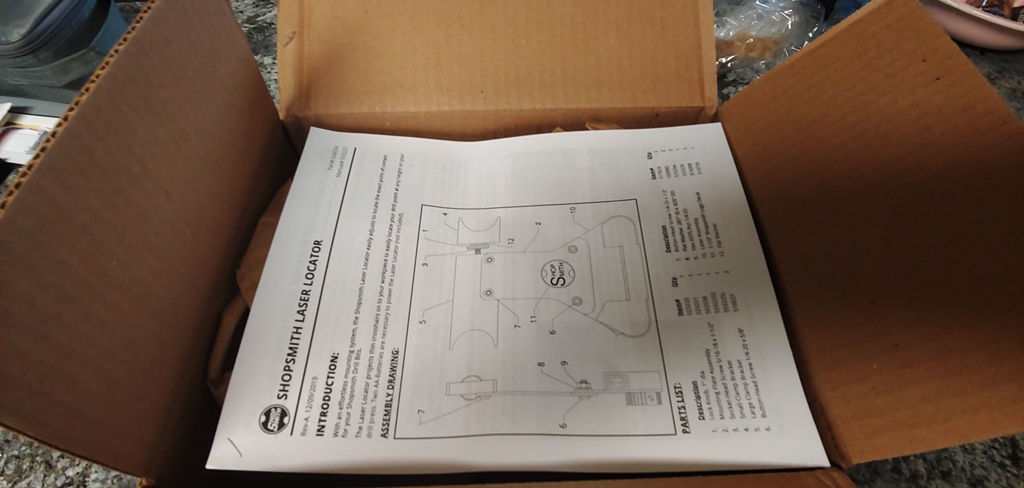

I got instructions with mine that just arrived today. I can scan them and send to you if you are able to get a replacement.

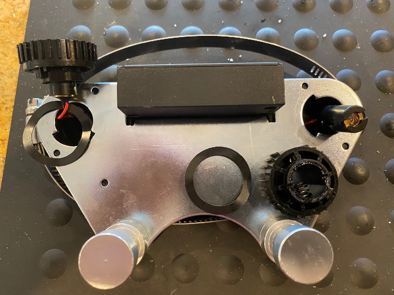

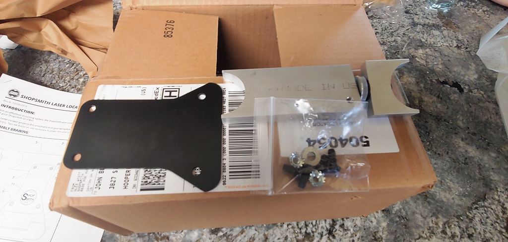

Probably the exact same problem for me though. All of the packaging was intact and the box looked good, but inside the Wixey clamshell the plastic rotatable mounts for the laser modules were broken on both sides. Kinda hard to align and set the lasers up if their mounts are all broken. I will picture it up and contact Shopsmith. Not looking forward to talking to them though after hearing about your experience. I guess I can always stop payment on my credit card charge (if they are a problem).

Since I didn't get instructions I'd like to get a copy to make sure I'm not doing something wrong, I doubt it but you just never know.
If you could scan it and post here that would be great or let me know and I will provide an email address if that is more to your liking.

Sorry, not the best quality, but this was the best I could get. The manual was very bent in the shipment. I placed a heavy weight on top just to get it to lay flat for the scan. Even with this, there is a noticeable distortion down the centerline of each page. Still, it should be readable.
Shopsmith_LASER_Locator.pdf
(3.38 MiB) Downloaded 2179 times

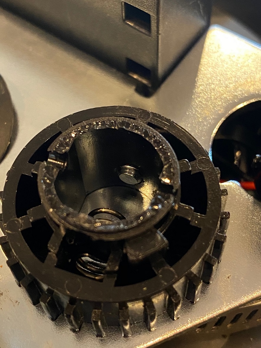

The Amazon one star review below pretty much sums up my thoughts on the Wixey laser after looking at the failure of mine that Shopsmith shipped. The spring washer seems to be too stiff to me. The black plastic mounts that the laser modules mount in seems to be very cheap. I could see that with time and maybe only a little vibration that the plastic would snap and pop off because that wavy washer has too much spring force which pushes against this plastic mount. Inside the clamshell it looked okay when I got this. It wasn't until I opened the clamshell that I could see these were falling out because it had already been broken. Bottomline, this Wixey laser could have been broken when it arrived to Shopsmith and they wouldn't necessarily be aware of it because it looks "okay" to anyone inexperienced in this product. Even if I get a replacement from Shopsmith, I would have to likely modify or hack this to a) get good repeatable alignement and b) get it to last any length of time.
Amazon Review:
Junk. I got it in May first; it is now June 22nd and it broke on its own. The plastic piece that holds the laser diode has a metal spring to pull the piece out so that there is some friction and the laser doesn't spin freely. Guess what: metal spring constantly pulling a plastic piece, metal wins and breaks the plastic. What a stupid design.

RFGuy wrote:Sorry, not the best quality, but this was the best I could get. The manual was very bent in the shipment. I placed a heavy weight on top just to get it to lay flat for the scan. Even with this, there is a noticeable distortion down the centerline of each page. Still, it should be readable.
I guess one is supposed to 'know' to use the 7/16" wrench on the keps nuts. :rolleyes:

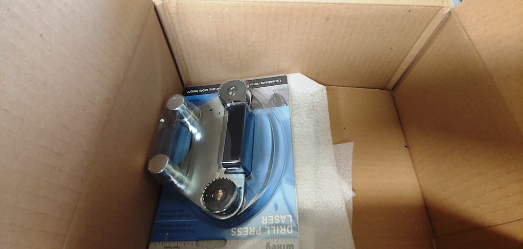

Re: Wixey Laser being sold by Shopsmith
I got mine yesterday. I have not unpacked the Wixey yet but all looks good. Packing from SS is typical of what I have gotten in the past.

jsburger wrote:I got mine yesterday. I have not unpacked the Wixey yet but all looks good. Packing from SS is typical of what I have gotten in the past.
John,
If you look at the Wixey pic you posted, the top laser has dropped down and you can see the spring on top. Pretty sure that top mount is broken, but the bottom one might be fine. Mine looked similar to this in the clamshell and it was only upon opening the clamshell that I found one spring down inside the metal assembly. Any movement of the unit after taking it out of the clamshell, I could see that the plastic mounts were broken BEFORE I even touched them. I would inspect it closely before even opening the clamshell. I highly suspect the top one is broken on yours.
The clamshell is a tight fit and holds everything in place, so until you take the cardboard off the back, you can't easily see it is broken inside. I was really looking forward to using mine since I am about to drill a bunch of holes in some steel C channel. Unfortunately, it will probably be weeks before I get my replacement. :(
