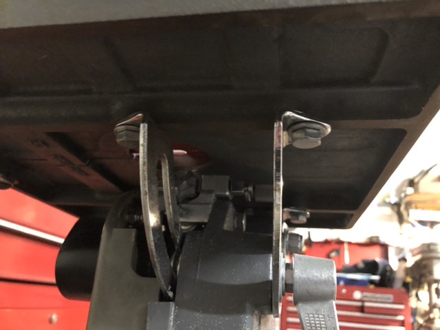

Bandsaw Upper Wheel Assembly .jpg (16.81 KiB) Viewed 4619 times
I have an old (cast iron table) bandsaw. there is a bit of play in the upper wheel. How do I get it off to either change or grease the bearing?
Re: Bandsaw Overhaul
You should find a clip that needs to be removed.
