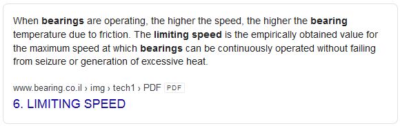

The link you provided gives a "Limiting Speed" of 15,000 RPM. If the idler shaft runs at 16,000 RPM, that could certainly be a problem. A Google search turned up the following definition of "Limiting Speed":
But as you point out, we don't know if that VXB bearing is an exact equivalent. I know for a fact that OEM's can order bearings with special greases and seals that enable operation at somewhat higher speeds.
