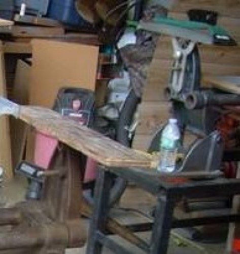

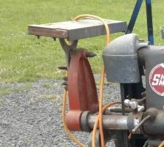

I had mentioned in my opening post about the Model 10ER I got for free from a person using the best parts from a 10E and a 10ER. He had put the Metal Extension Table on the Wood Bracket and Tailstock. He kept the 10E Headstock for his along with many of the 10E parts. Below is a picture of his Model 10 with the Metal Extension Table on the Wood Bracket and Tailstock. In the foreground is the one I received with the old wood on the Metal Bracket and Tailstock. Notice on his he used a Knob and Stud in the upper Stud and Wingnut hole of the Tailstock.
It is possible to use the Base Plate Knob and Stud Screw in place of the Tailstock Stud and Wingnut. These varied slightly in length and with a washer the slightly longer ones will work as shown in the picture below. I believe this is what Everett was showing in one of his documents about different part versions.
Until this week that was the only time had seen someone use the Metal Extension Table on the Wood Bracket and Tailstock. Right now, there are two Model 10E’s for sale set up that way. One is for sale near Eugene OR and the other is for sale near Everett WA. Notice the in the second picture for the one from Everett WA it is using a Mark 5 Extension Table which is even stranger. It still has the Model 10 Main Table and early Fence without the rear lock.

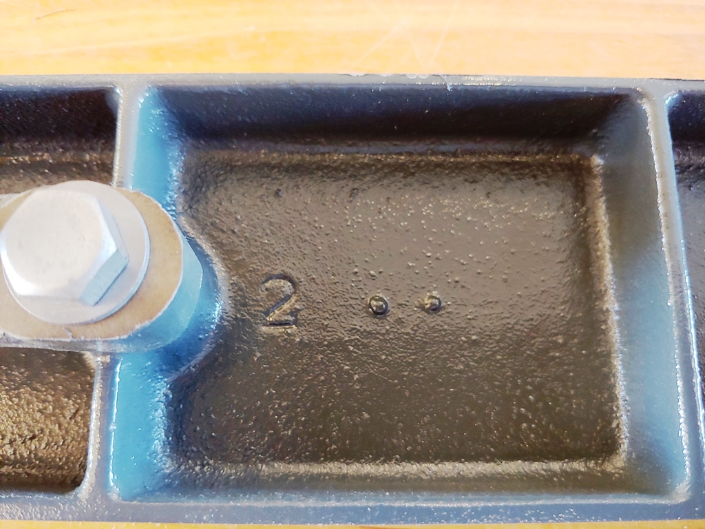

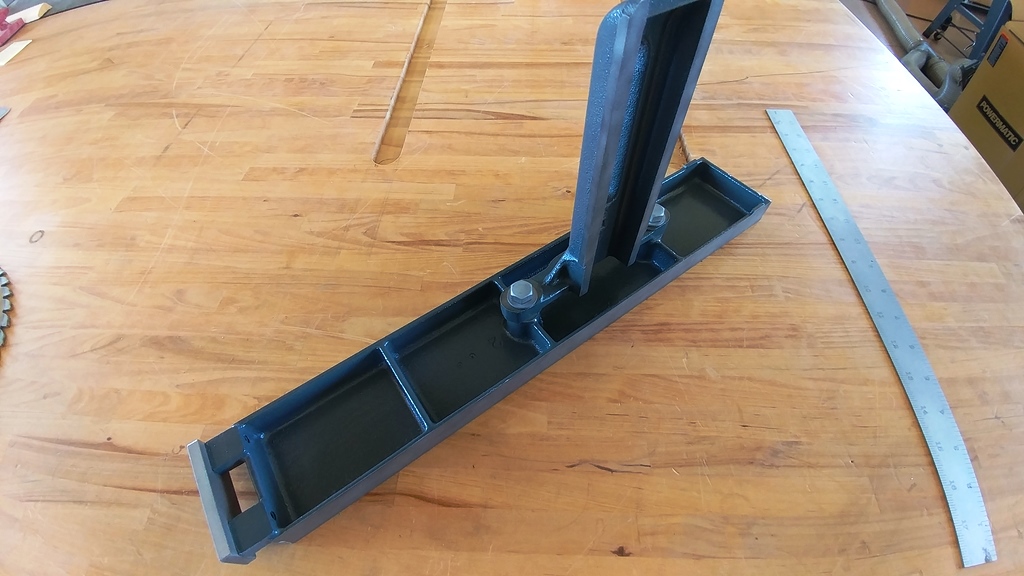

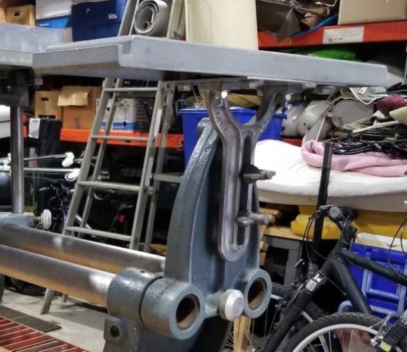

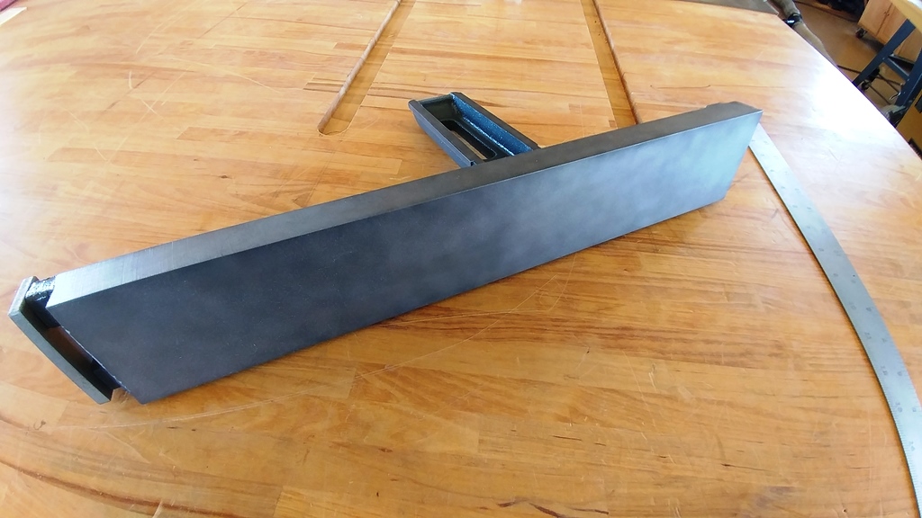

Speaking about extension tables, what have you found on the cast iron extension table? They are very rare. I have only heard of maybe 2 or 3 besides the one I have.
- Cast Iron 1.jpg (223.94 KiB) Viewed 15397 times
- Cast Iron 2.jpg (236.16 KiB) Viewed 15397 times
- Cast Iron 3.jpg (341.66 KiB) Viewed 15397 times

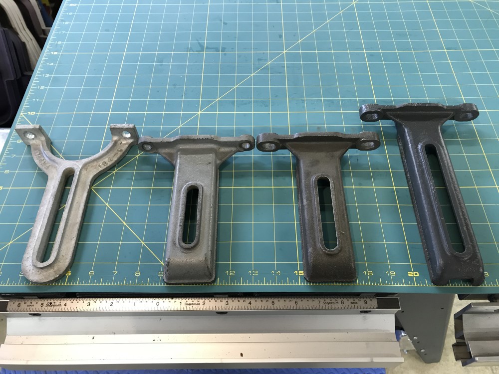

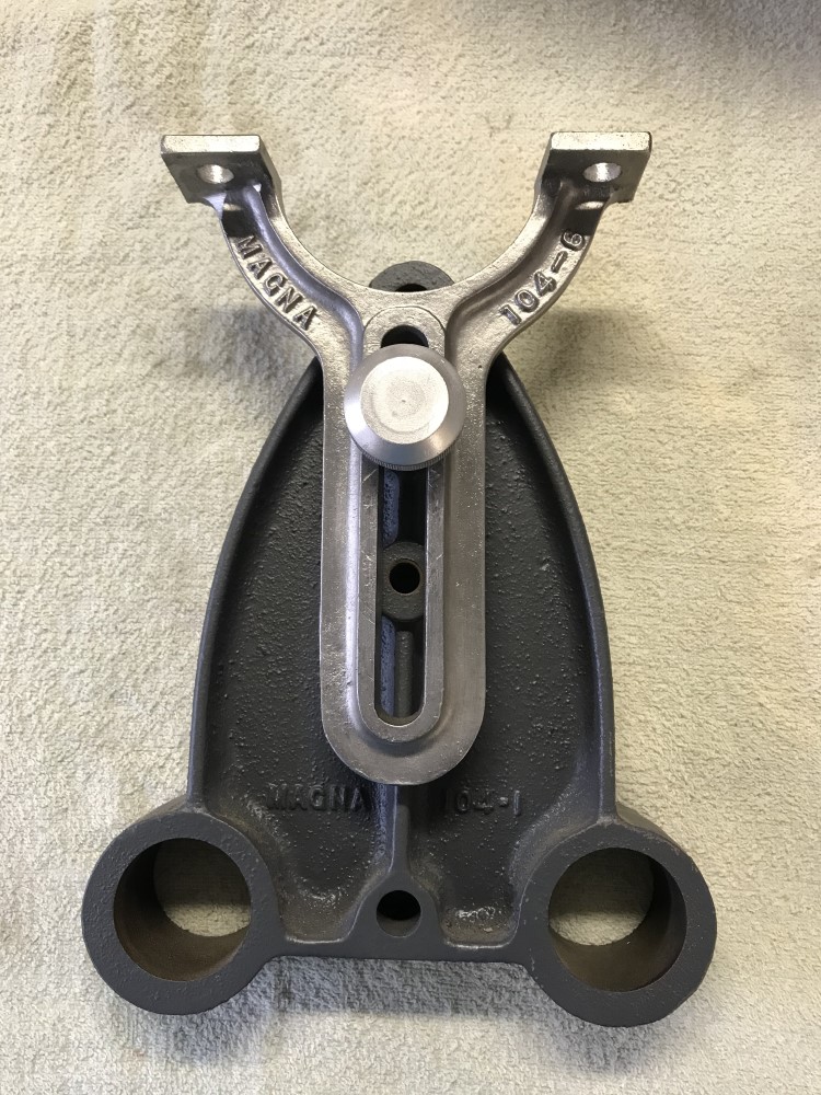

- Posts: 4536
Re: Shopsmith Model 10's What When and Where
John,
You know more about them than I do since you have one. Besides yours, the only one I have seen pictures of is the one for sale on eBay Ron provided the link to. He (Karen's husband) has been trying to sell it off and on for a long time. Best guess, as we previously talked about, is that they were a prototype Metal Extension Table made when preparing to change from the wood one. One thing I noticed on both yours John and the one on eBay is the Bracket. Both have the adjustable one with oval slots for the mounting bolts. Is yours the Bracket that came with it? Below is a picture of the 4 different Table Brackets I have had. Note the 2nd one. Also they are in the order I believe that they came out based on the Serial Numbers they came with.
The 2nd one with the round mounting holes is not a common one as far as I have seen.
Hard to tell for sure from the photo, but the bracket on the one John has appears to be the type 4 (long) bracket, If so it would possibly indicate it being late in production rather than early.chapmanruss wrote:John,
I know we discussed this before. I just thought I would put a post in this thread that is all inclusive of all things Model 10.chapmanruss wrote:John,
Yes, that is the bracket it came with. It is the third one from the left in your picture (7" long).
