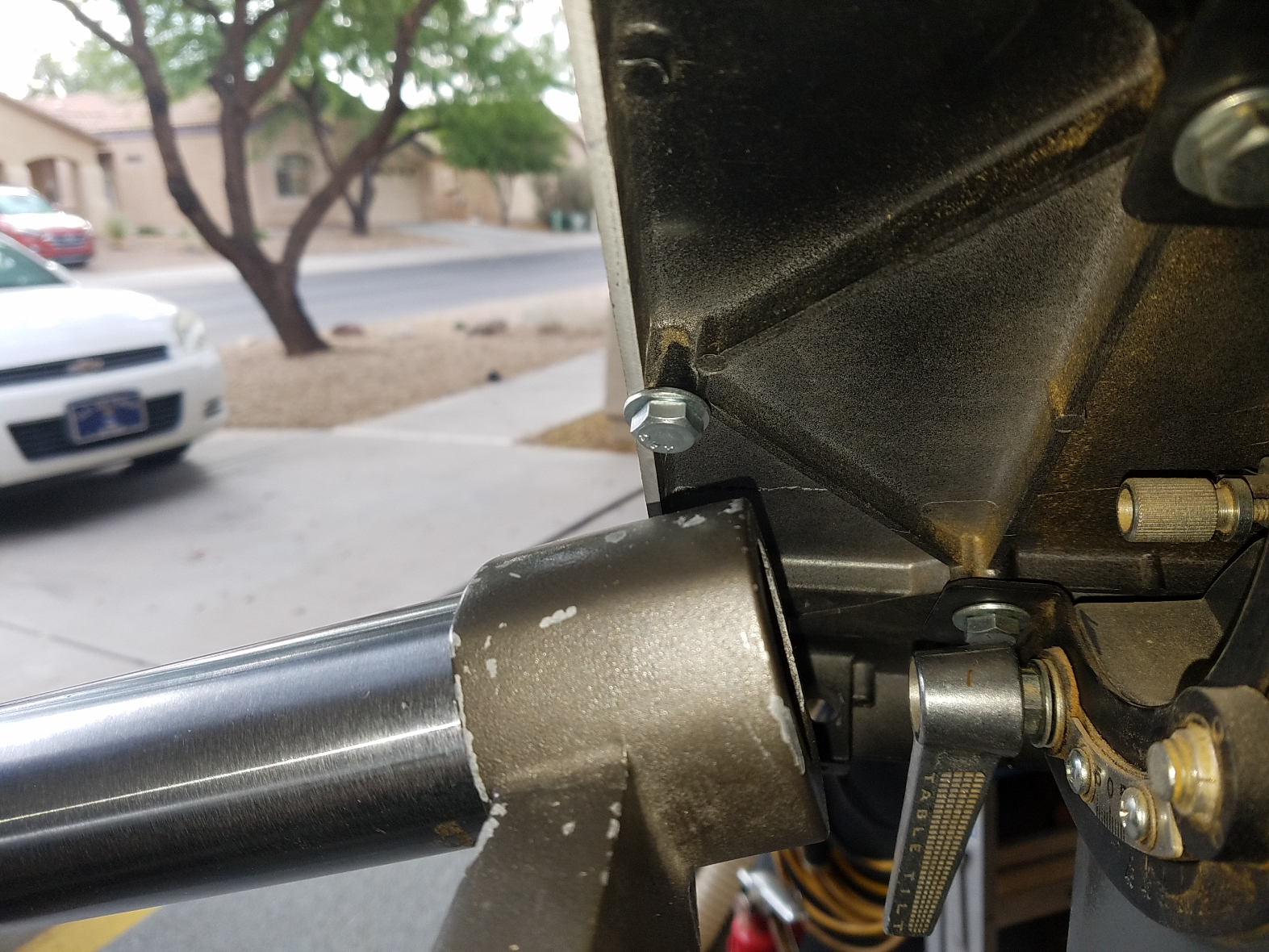

At this point, this is most probably a lost cause. Not being intelligent enough to listen to others, I decided to prove my point. The Bandsaw, when mountedr in accordance with the intsructions onto a 510/520 that has been built an assembled in accordance with those same manufacturers instructions can be placed into the vertical drill press mode. Yes it can! But...not without an awful lot of extra (and undocumented) effort.
This photo shot very clearly and unarguably documents my final understanding of the situation. Please note that I have even taken the rip fence lock rail off of the bandsaw table. Even then, there is NO CLEARANCE and it is not just a fraction of an inch.
NO CLEARANCE with the Bandsaw mounted on the Headrest casting.
This could easily be changed with a design modification but, obviously, we are beyond that point in time.
