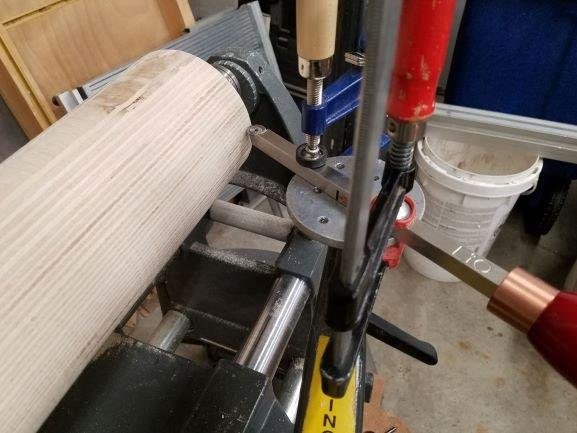

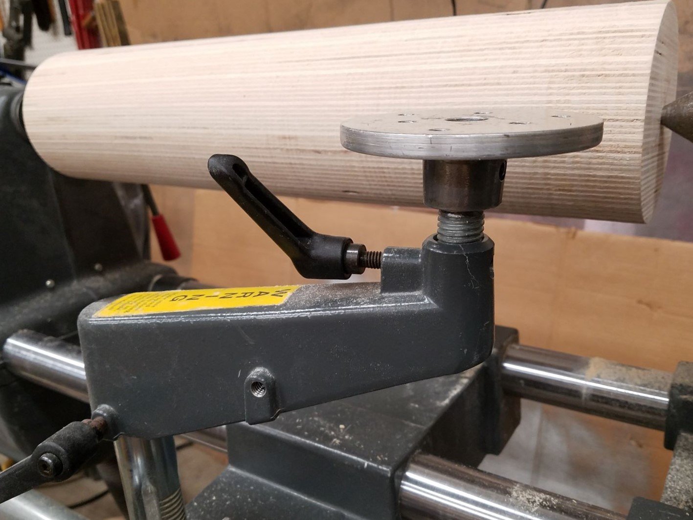

Here's some pictures with the homemade adapter. First picture merely shows how the homemade adapter fits between the faceplate and tool rest arm. In use, the bottom of the faceplate rests on the top of the tool rest arm.
adapter connecting faceplate to tool rest arm
easy wood tool clamped to faceplate

Hal - Do you prefer this one to the jig you made with the threaded rod adjustment? If yes, why?
- David
hfmann
Posts: 295
Joined: Fri Dec 08, 2006 9:04 pm
Location: Perrysburg, Ohio
Re: precision spindle -Proof of concept -
Post by hfmann »
Hi David,
It depends what I'm doing. If I need precise diameter, I like the one I made with the micro adjustment. This one is faster to setup but not as precise. I find there is a little play in the post that connects the tool rest arm to the SS carriage and that gave me slightly inconsistent results across the length of the turning. Not a problem in most cases I suppose.
hal
